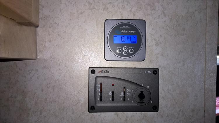

Wiring the Shunt
I unplugged from shore power, turned the battery switch to off, and unplugged the solar cables. I made sure to cover all ends of the cables with electric tape while working with them to avoid any unwanted, shocking, experiences. Here is how I am currently wired:
  • The positive of the first battery goes to the second battery. This allows the two 6v batteries to be connected in series and give me 12v. Nothing else connected to battery 1.
  • On battery 2, from the positive, I go to the battery switch. I had previously wired the switch to the negative, but with the shunt wired to the negative, I believed it to be better to wire to the positive. The Blue Seas switch I am using is designed to be connected to the positive and I am using a high quality battery cable to connect to the switch, being careful to make sure no metal can be touched between them. Also from the positive side is a wire to go to the shunt.
  • On the load side of the switch, I have the positive wire to the trailer and the 2 Zamp positive wires. (I installed a second Zamp port.)
  • On the negative side of battery 2, I have the cable going to the shunt and nothing else but the cable coming from battery 1.
  • On the shunt, I connected the negative cable from the battery to the battery side of the shunt, and to the load side of the shunt, I wired the negative trailer wire and the 2 negative Zamp cables.
Fishing the Wire
The installation was not complicated. I used a wire fish tool and was glad that I did. Here were the steps I followed for fishing the wire:
  1. I fished through the wall, then taped the end of the RJ45, making sure to wrap and protect the connector so that it did not catch on other wiring, and then pulled the wire back through the section that I had just fished. I started with the bottom cabinet below the sink in my S model, fished it through the opening to the left that led up the wall to the area behind the toilet, where the little hatch is located.
  2. From there, I located the are on the bottom left, where other wires ran, and into the area in the driver side bench.
  3. Next, I drilled hole from the cabinet below the sink to the small storage space below the fridge.
  4. Then, I removed the vent in that storage area and cut a tiny hole in the screen, just enough for the RJ45 to fit through. That screen needs to be sealed if you cut it. You can sew that closed or use some type of sealant. I am planning to do both.
  5. I then fished the cable through, where it exits via a vent. I fished the cable through a semi-rigid wire loom and secure it below the T@b by utilizing existing wiring. It created a very tight hold on the looming. My battery box has a space for the looming to enter the battery box. Once it is there, the cable just connects to the shunt.
Completing the Installation
To complete the installation, I:
  1. Removed the Alde control panel plate and fished the RJ45 cable through that hole.
  2. Used a hole saw and hole saw attachment with my drill to create a hole for the display above the Alde panel hole.
  3. Brought the RJ45 cable up through the new hole and connected it to the display.
  4. I then snapped the display into the provided mounting plate and out the display into hole.
I did not use the provided screws for the mounting plate. I may install them, but the mounting seems snug enough without them that I would like to try that first. I may also use some 3M mounting squares instead of the screws.
Thanks to everyone who offered advice, it all came in handy. I am very pleased with the monitor and believe this will really help me have a better understanding of my battery and how my power usage is really impacting the state of charge.
