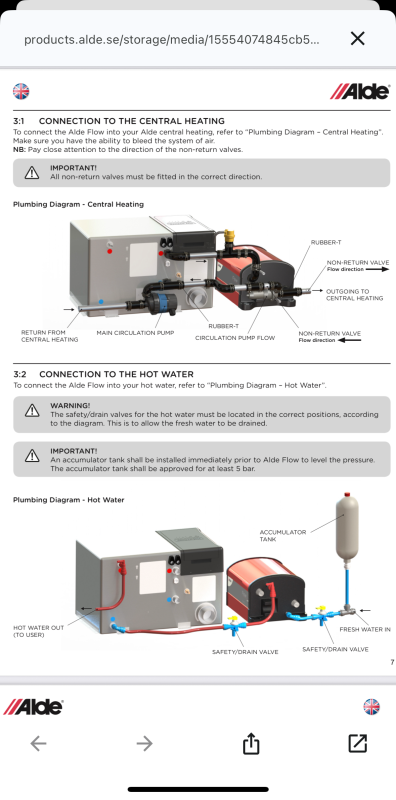

    qhumberd Administrator, Moderator Posts: 879
    @ssheets9  The Alde mystery story continues. Glycol, corrosion and the control quirks keep the forum humming.
    On my Alde with the Flow attached, the two pumps both circulate glycol. That seems to be supported by this diagram of glycol and water connections on this installation manual below. Not sure what the tech at NuCamp was describing. No pump on the water connection in the diagram below.
    New to me on this diagram was the “accumulator” tank, which seems designed to obviate the refresh of the air space in the hot water tank?
    https://products.alde.se/storage/media/15554074845cb5a27cef5b9/v-302019-rev1636-installationsanvisning-alde-flow.pdf
