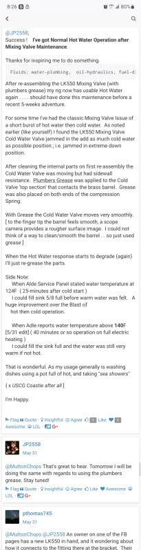

    MuttonChops Member Posts: 2,088
    @jalars8;  Have you seen the LK-550 Maintenance Guide ?
    Check this resource,
    last posting title "LK550 Mixing Valve Operation and Servicing"
