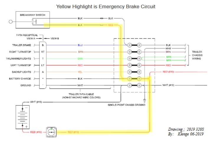

    Here's a wire diagram I found for a 2019 320S. It shows that the breakaway brakes need the battery switch on to get power to the brakes when not connected to the tow vehicle.
    I've always thought that my 2020 320S was the same. Has nuCamp changed this on newer or different models?

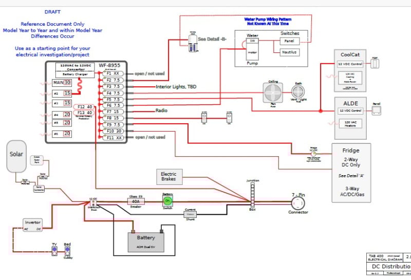

    It is clear from the wiring diagrams that have been discussed on this forum that the 400 is wired so that the power to the trailer brakes is received from the trailer battery in event of a TV disconnect. This circuit is NOT powered with the battery disconnect off. I believe this should be easy to confirm on a trailer as follows:
    1.  You can jack up one wheel with the trailer 7 pin disconnected from the TV. Trailer battery is ON (battery disconnect in ON position).
    2. Pull the emergency breakaway pin on the frame and the lifted wheel should lock up with brakes activated.
    3. Then turn the battery disconnect to the OFF position (trailer battery is OFF) and the power to the trailer brakes should cease and release the brakes, allowing the wheel to turn again.
    Allowing a critical safety component to be disconnected by the owner due to the confusion you described is clearly not optimal. You would hope that a design is possible that would remove the human factor.
    If the above procedure is incorrect I would really like to hear about it.

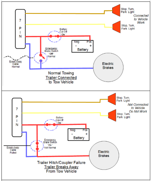

    PS: The circuit below does not include the breakaway switch, but shows the disconnect in line with the terminal going to the brakes

    The easiest way to test in a newer trailer with a Victron device: with the battery switch on, pull the emergency brake pin, and have a look at your Victron.  It will show a constant 6 amp draw while that pin is pulled out.  Turn the battery switch off and have a look at the Victron again and note the 6 amp draw should disappear.
    For those of you who have not "pulled the pin" on the emergency break away switch: it is very hard to pull out.  It is even much harder to get back in.  The pin is small, and not conducive to being "pushed" back into the breakaway "box" there on the tongue.  My wimpy hands could not get enough grip to shove it back into place.  I used a pair of pliers for a good grip and better force.
