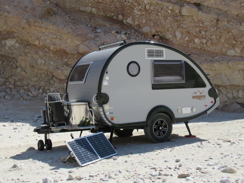

    We bought a suit-case portable that allows us to easily move it around to maximize sun exposure. The option to place your T@B in the shade while still charging good amperage is wonderful

    @Cherokee gives good advice here, the flat portable ones are effective and a good compliment to the curved ones on the roof. They open up your options when you have a shady site. More is better, but even the 100w can help a lot.

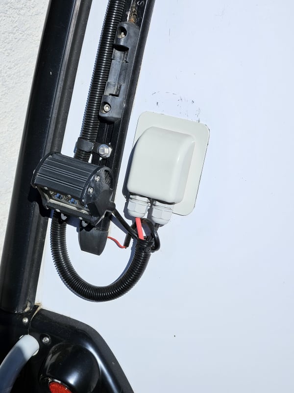

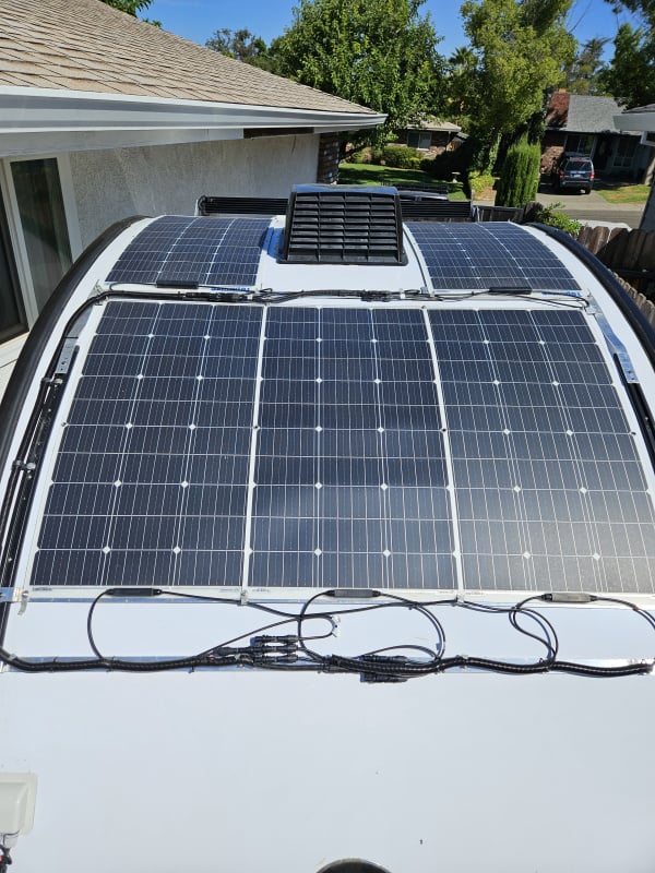

    I purchased 6x100 watt flex panels, veriaty of them on Amazon, and installed 5 of them on my 320 BD. Being that roof is somewhat cursed on good sunny day i get good 300 + watts out of them. When comes to wires boondock has two lights on the back, so I replaced wire gland for one of the lights to larger one and used it to run my solar wires inside.

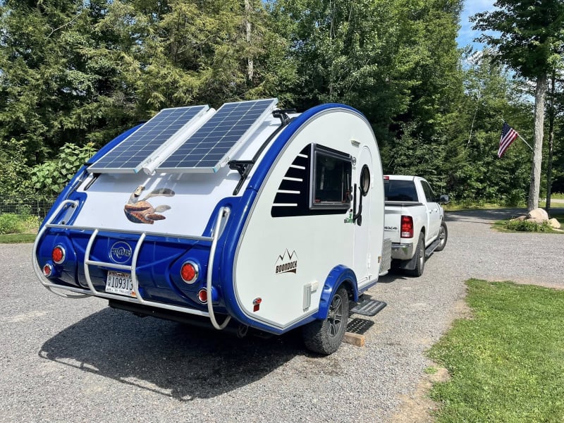

    Mounting the solar panels on the rear rack is perfect - the air traveling below the panel will will allow the panels to run cooler and more efficient

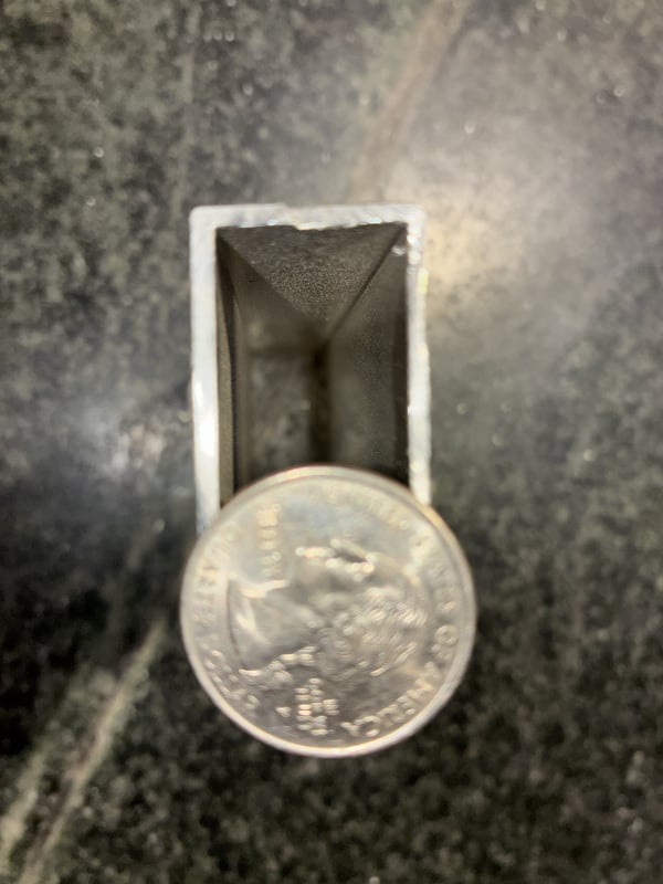

    The factory flexible rails attached to the roof do not distribute the load and have a low weight rating.  Any load is concentrated on the aluminum frames rectangular tube directly under the cross bar. Each rail is attached with a single sheet metal screws going through one wall of each of the thin walled aluminum frame tube. Maybe eight screws per side.
    With the @Cherokee setup I'd worry more about the up lifting his solar panels will create at highway speeds and potential for pulling out screws that have limited thread engagement.
    It sounds like you've successfully traveled this way, so you're not concerned. Just a heads up to others to do more research and analysis before attempting this. Maybe ask nuCamp what they think.
    edit to add picture of frame tubing for reference ...
    With this setup I'd worry more about the up lifting the panels will create at highway speeds and potential for pulling out screws that have limited thread engagement.
    This IS NOT my T@B, in fact, I removed our rack when we go a truck with a Leer shall - the image came from a 320 face book page. Of the many comments Bruce received, no one mentioned this issue. Nu Camp rates the the rack at 60-70lbs (depending on the year). I couldn't find a  airflow study on a 320 that would confirm your concerns. However, in the real world I've met people carrying kayaks mounted on the rack on a 320 crossing the country from white water stream to white water stream. The area of the kayaks was MUCH larger then these panels. I met them on their return trip. They remarked they had no problems. I posted this because it didn't involve additional roof penetrations to mount the panels.
