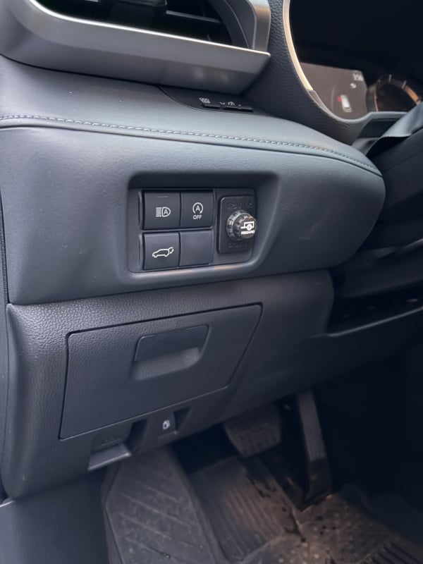

    Agreed.  I just installed a Redarc in our new Highlander this past week.

    That’s the cleanest aftermarket install I’ve ever seen! Slick! I wish they had a solution for my 2014 Touareg!

    Redarc has a variety of inserts.  The one I used is universal.  Just drill two 1/8" holes a half inch apart, then re-drill the lower hole to 1".
    https://www.redarcelectronics.com/us/trailer-brakes/switch-inserts

  • Horigan
    Horigan Member Posts: 893
    Sounds like you’d need to drill holes anyway to mount the controller at a driver-accessible location.
