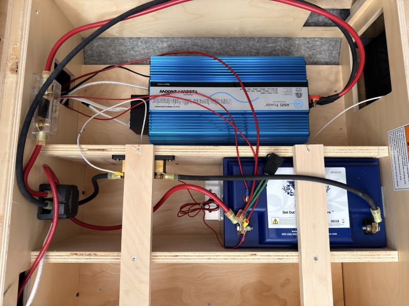

Hi friends, I have a 2024 400 BD, stock with one 100Ah Battleborn battery and 1200W inverter, 310W solar panel on the roof. In the interests of boondocking for longer in shady northeast sites (running the fridge off battery, AC only when electric hookup is available), I’m thinking of replacing the standard single Battleborn with one higher-capacity battery. I realize there are multiple ways to achieve my goal (suitcase solar being one), but I’m thinking a one-for-one battery swap is the simplest and cleanest. I’ve got limited time for a “project” so I’m here wanting to check my impression that swapping in a new battery will be a straightforward affair!
In other words, is it basically a drop-in upgrade, or am I missing something?
What *think* I know:
  • A new battery (e.g. 320 LiTime mini) will be larger than the Battleborn, so I’ll have to make sure it fits, adjust the wood braces, and maybe strap it in. Seems easy enough.
  • I’ll have to cap or tape off the lead to the battery heater switch.
  • I’m not starting from an AGM battery, so my Victron solar controller should work fine, but I should make sure the voltage set points are correct for the new battery
  • There’s a fork-looking connector on the bottommost little red wire that I should replace with a ring connector
What I’m not sure about:
  • Assuming the same wires reach the new posts, it looks like the diameter of the screw-on terminals for the LiTime (for instance) is slightly smaller than that of the Battleborn (5/16 vs 3/8). Does this matter, if all of the ring terminals of the cables are screwed in nice and tight and making good contact with each other? It seems like some folks add busses to make everything neat and tidy, but can I get away with just moving over the same wires?
  • Because I am not upgrading the inverter, just increasing the Ah of the battery, do I need to think about or upgrade the Gloso battery circuit breaker?
  • With the Victron, other than punching in the new Ah of the battery, do I have to do anything else? As far as I understand it, the idea is that the SmartShunt detects when the battery is fully charged, and then tracks everything coming out of the battery from that known point in order to determine remaining capacity.

    It's pretty much a drop-in as you described. If you have the tools to crimp a ring terminal onto the fat wires do it but it's not super critical. Personally I'd get a battery with a bluetooth BMS which tends to know more about the battery than the victron battery monitor.

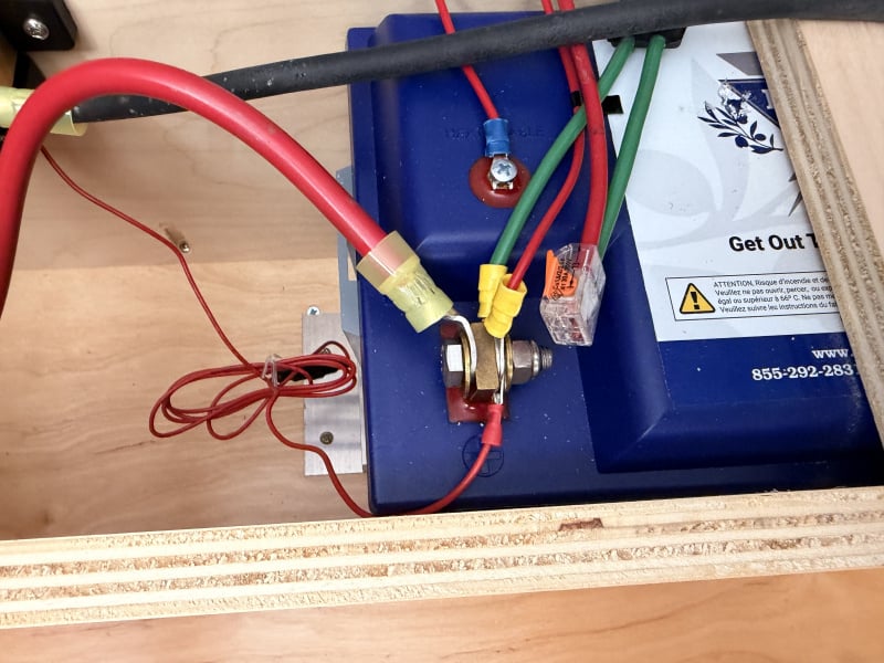

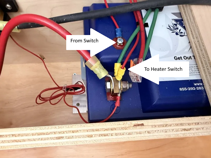

    Disconnect these two red wires (to and from the switch in the cubby) to safely disable the heater switch.
    The switch will not have power at that point. You may want to keep the wiring in place in case you come up with an ingenious use for the switch in the cubby later on.

    @RTWCTS thanks for the diagram. And you’re right … the toggle switch next to the bed will now be begging for a purpose! That’s going to keep me up at night figuring out what to connect it to, I need to call up Q from the Bond movies for an ingenious gadget 🤣

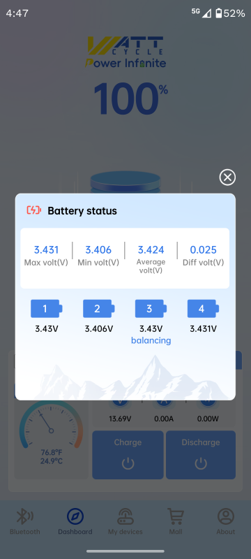

     I don't disagree @B0atguy, but they were sold out of non-BT models when I needed one. But now that I have the BT I'm kind of glad I do, it's nice to have a 'second opinion' on the SoC if needed. Plus the BT reports cell balance status, and the app interface offers BMS diagnostics (so far not needed). I still feel the Smartshunt is the more accurate way to determine power in/out.

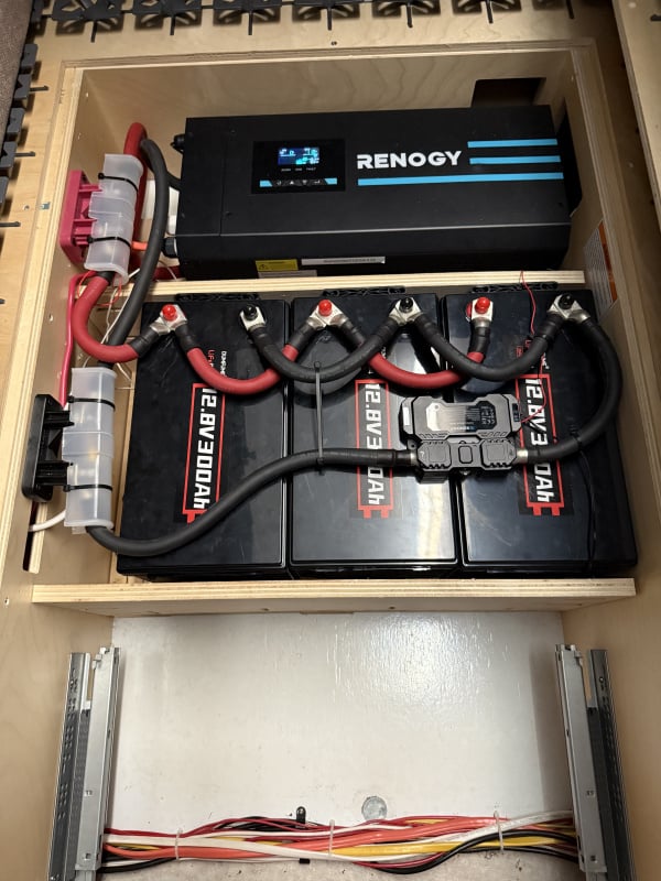

    I justified the upgrade by using the old batteries for a home built power station. Amazingly the new batteries fit fine in the same location with only a mod to the battery boxes. My wife bought into the upgrade since she likes the freezer in the back of our tow vehicle.
    .https://tab-rv.vanillacommunity.com/discussion/20295/power-station-build#latest
    That box could have handled a third battery. Something to think about.  =)
