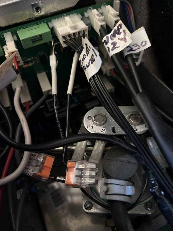

    I ordered and received the thermo fuses from digikey. I am nervous about soldering them onto the control board and don't know how to find someone that might do that for me. But I wondered if I might solder one of the fuses to alligator clips on either end and bypass my current fuse following the jumper bypass example in this post.
  • madisontadpole
    madisontadpole Member Posts: 8
    I'm gonna probably give more questions than answers. Thing #1 …have you confirmed the ALDE works when you use a simple temporary jumper around the thermal fuse? if you have proved the thermal fuse is faulty: You are right to be concerned with soldering a thermal fuse…It's very nature is to "blow" when it gets hot. Soldering as a process uses extreme heat. As I was messing around with my fix, I tired soldering a thermal fuse "just for fun" and triggered it. That is one of the reasons I went to the screw terminal. Here is the big question. (hopefully big brain folks can chime in) What is the thermal fuse designed to protect in everyday operation, does it trip because the ambient temperature of the PCB exceeds the set level, or does it trip because the current/resistance through the thermal fuse cause the component to trip. If the safety trip is for ambient temperature, I would be concerned that the bush fix is not a good long term solution as the dangling wires get the thermal fuse too far away and not in direct contact with the PCB to accurately monitor PCB temperature. If it's protection is supposed to trip due to current/resistance, I would feel a little better about the bush fix. If you look at the bush fix device, it appears no soldering has taken place, it looks like the wire from the alligator clip was wrapped around the legs of the thermal fuse and clear heat shrink holds it in place. If I were you, I would look for PCB repair services in your local area. (google PCB repair near me) Take them the board and the fuses from digitikey and have them do it. Here is one close to me in Greenville, SC. https://circuitboardmedics.com/ hopefully you can find similar.

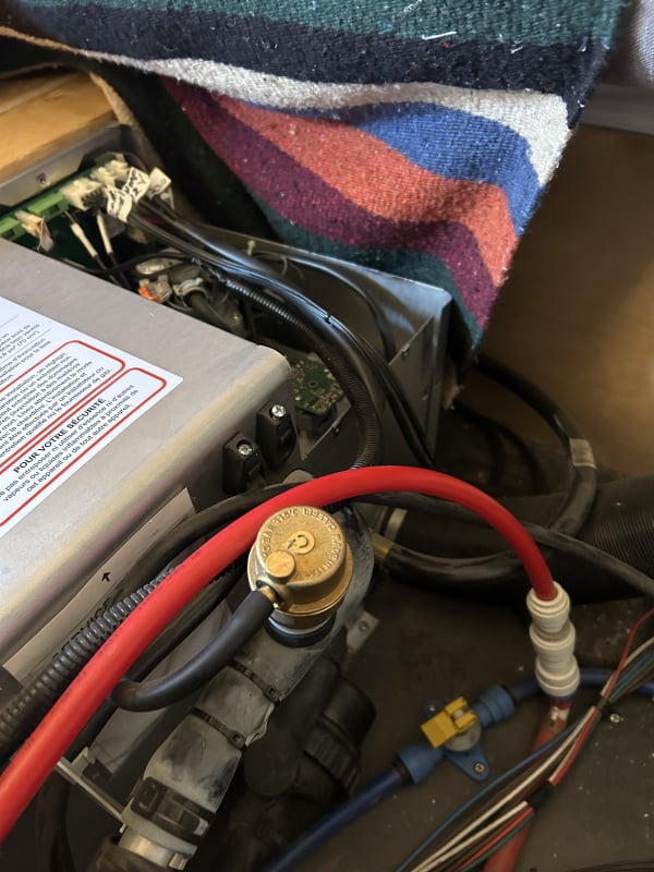

    Happy Father's Day everyone. I rigged up a jumper to see if it would get the Alde going. After leaving it overnight still no heat is circulating. None of the rubber tubes coming out of the heater have warmed up, but the brass piece showed in the photo is hot. So it seems that the heater is going but not pumping. Does that mean that the jumper bypass is doing the job and the thermo fuse was bad? Is there some other obvious reason that the pump is not going?
    pthomas745 Administrator, Moderator Posts: 4,658
    The brass fitting is the "Auto Air Bleed Valve". If that is hot, then yes, the Alde is working. We haven't asked what year your trailer is: but, if you have the touchscreen Alde panel, you can find the "Service Menu" and it will tell you the glycol temperature, which will give even more proof.
    The glycol pump starts when the Alde thermostat "calls for heat". The "requested temperature" you ask for has to be higher than the temp inside the trailer, and the Alde thermostat's opinion of the temperature inside the trailer can be quite a bit off. So, try increasing the requested temperature and see if that starts the pump going.
    On my trailer in a warm state, to test my Alde pump, etc in the summer I use an ice pack on the shower wall behind the Alde screen to trick the thermostat. (The thermostat is a tiny part on the control panel board).

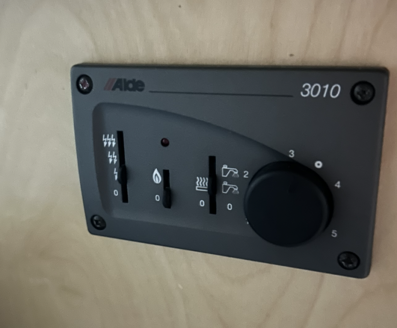

    Show us your manual panel settings. If the Auto Air Bleed Valve is warm, that means the Alde is working. On my 2017, the control panel is on the wall behind the shower. I placed the ice pack on the wall in the shower. I would suppose if you had a good way to make sure no moisture managed to get to the panel, it would work on the panel itself, also.
  • RollinWithShirley
    RollinWithShirley Member Posts: 48
    This is my control panel. It seems that the temperature sensor may be behind the temperature dial.
  • ScottG
    ScottG Administrator Posts: 5,688
    I have the same panel and I believe you are correct. I had to trick mine into starting once by blowing cold air over it.
