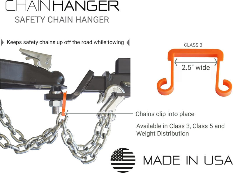

    Never posted the previous comment, lol. 8 weeks in and in Illinois — no additional significant issues. Have noticed the camper pulls better when the tanks are around half full. Believe this is due to all storage, clothes and bed weight being up front, the tank weight evens it out. Probably will invest in WDH or air bags to minimize dip. Also will be getting the pitched axle - we haven't dragged much, but the chains show wear from bumpy roads and such.

    @gkreitzburg, with regard to your comment about the signs of wear to the tow chains, in addition to considering shortening the chain length, an inexpensive option is a safety chain hanger, such as this one. I recently purchased one and will be trying it out on an upcoming two month trip.:
    https://www.amazon.com/GR-innovations-llc-Safety-Trailer/dp/B089S5BKR9?th=1
