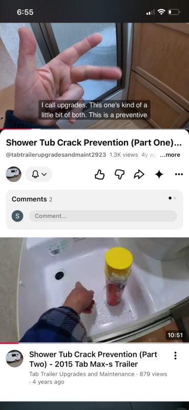

There is a 3 part video on you tube on how someone reinforced the shower floor. Can’t seem to find the link , but here is a picture that might help to find it.2025 360 CS

Thanks for the video suggestion. That is a video that I watched a few months ago but his 2015 is more accessible to that area than my 2025. My floor drain is in the center and I don't have that access box underneath, unless it is hidden under the plastic liner that is covering the bottom of my Tab. I also could not see anything from the wheel well area as he did. I am going to try that again tomorrow and see if I just wasn't bending my old body enough to get a proper look, lol. I watched one video, not sure if it was his though, where they actually cut a small square out of the shower pan near the edge and filled with foam underneath then Fiber glassed a repair patch in. I don't care to go that route unless it has begun to crack already. I'm going to do something, just haven't figured out what exactly yet. That bottom flexes way too much for my comfort.
