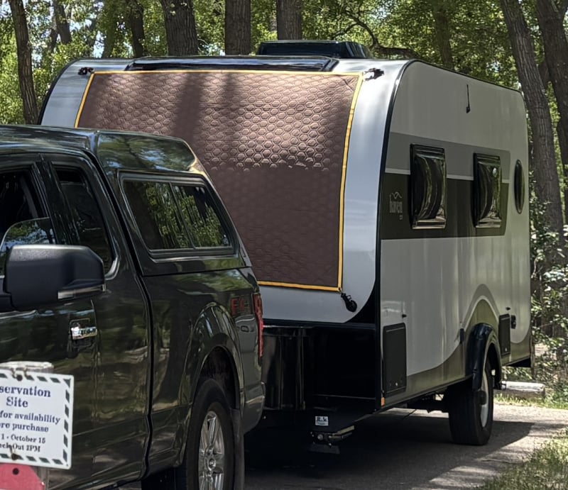

Very creative! I also became concerned about a broken front window on my Haven after a 3,000 mile trip from Denver to CA national parks & back. I have WeatherTech mud-flaps on front & rear wheels of my 2018 F150, but noticed rock dents on either side of the black front storage box. I did a lot of research, & everything I found required gluing, riveting, or taping around the window & I didn't want to "experiment" with an unproven solution. Also, that only protects the window & not denting on the rest of the front.
I'm using a $45 CAT Utility blanket, water resistant on the outside, soft on the inside (hasn't scratched the window) 72" x 60" slightly padded, with grommet holes along the sides. I should have gotten the 72x80 to protect either side of the window as well. I ordered another 72x60 and will sew them together to protect the whole front. I'm using Airhead SUP Suction Cup Tie-downs (come in a 2-pack $17) to attach the padded blanket tarp over the front of the trailer. I'm happy to report it worked on a round trip to Devil's Tower & back, driving through some hellacious winds. After about 400 miles, one upper suction cup came loose. When I pulled over to re-attach, I noticed I didn't pull the clear film from the cups. I did so, reattached all cups and they haven't come loose again except when I pull them off. I wiped back of cup and surface of attachment with rubbing alcohol.
