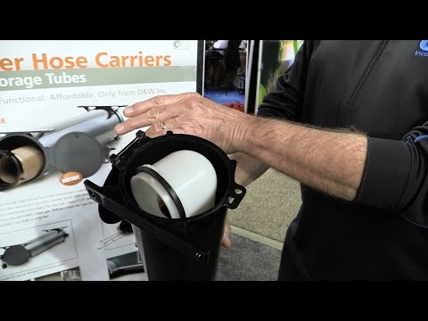

This company claims their tube holds "everything." The inner dimensions are 4 5/8th, which is apparently the new perfect.
https://www.dwincorp.com/product/super-slider-adjustable-super-tube/
There is one video
https://www.youtube.com/watch?v=_xlvdJt5adw
Which apparently shows everything (right angle attachment and the graduated dump station connector) going into the the tube.
