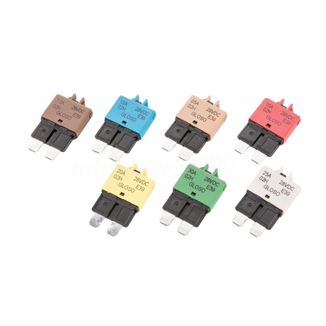

    Perhaps it is time for Alde to switch to circuit breakers.  Seems to be a common problem especially for new owmers.  You don't have fuses for your house anymore.

    Can they add a 12 volt circuit breaker?

    Here's some blade fuse sized breakers! Cool! Might have to look into this!
    On eBay: https://goo.gl/rLkVKD
    (But then again, I've never blown one of these 12v fuses in the Tab...)

  • rajamar
    rajamar Member Posts: 112
    Slide down on the eBay link ChanW posted above. 12-24 volt circuit breaker that can also be used as a kill switch. 3.2" x 2" x 1.6"
