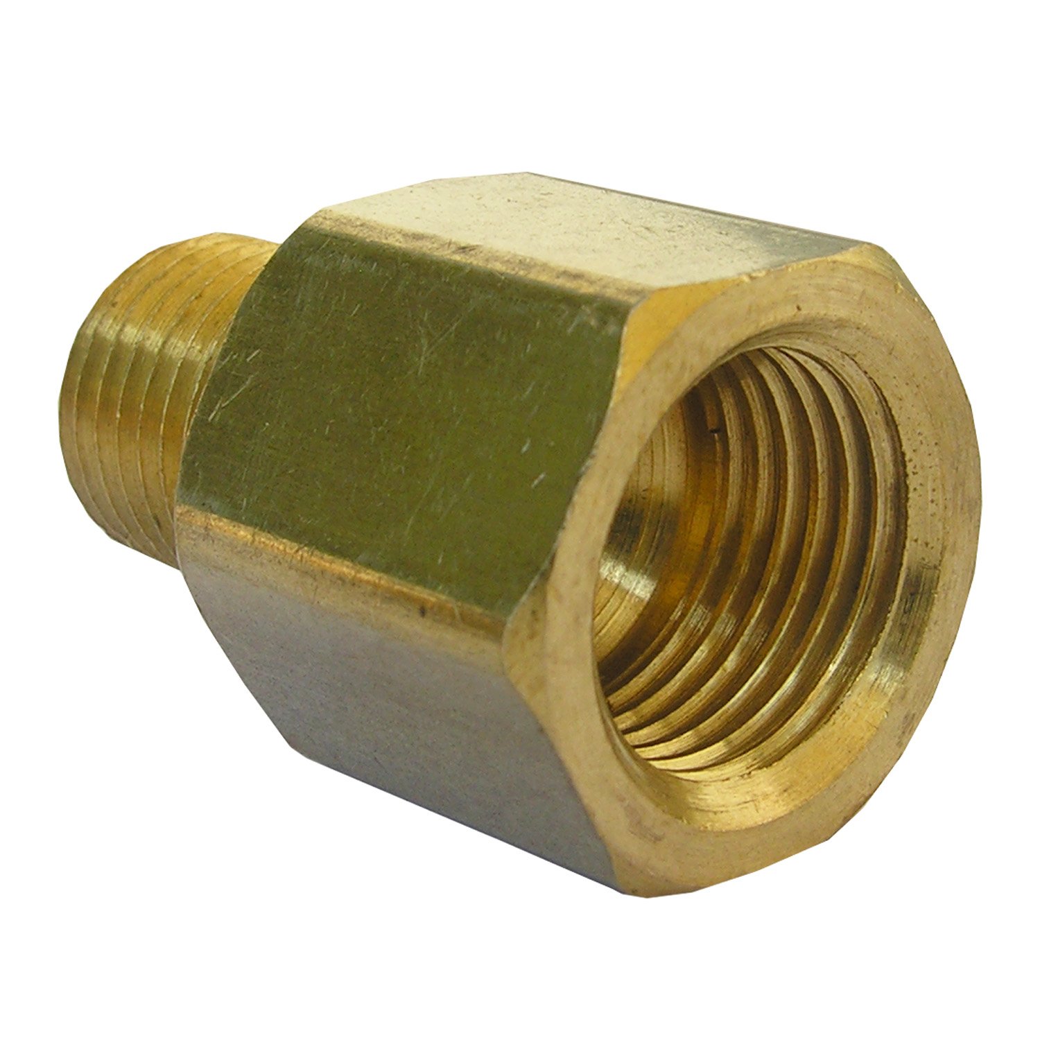

  • db_cooperdb_cooper Member Posts: 737
    edited June 2019
    That was the easier one for me to find. 😁
    FasParts 3/8" Female NPT FPT FIP to 1/4" Male MPT MIP Brass Pipe Adaptor Fitting Fuel / Air / Water / Boat / Gas / Oil WOG 250*F 1000 https://www.amazon.com/dp/B013RXD39Q/ref=cm_sw_r_cp_apa_i_fwD.Cb493M3DQ
    The female side does flare, and the male side is flat.

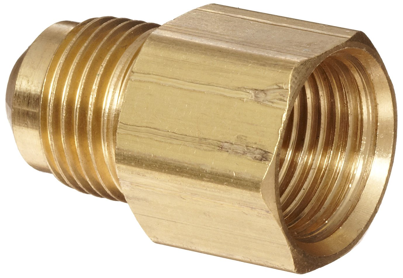

    @ChanW -  You're correct, that part didn't fit.  I have the correct part for the left side of the equation.  I think this part is the missing link.
    It is 1/4 FPT (female pipe thread) which should be the same as Female NPT.  I'm going to check my local fireplace/woodstove/BBQ joint to see if they have it, and take the other fitting to confirm fit.  Looks like it might be more common in grill applications.

    I think what you're looking for is a ⅜ female flare (non- "inverted") to ¼ male MNPT.
    And a ¼ female FNPT to ⅜ male flare.
    To complicate things, from what I can tell, there are two types of NPT threads, straight and tapered. Also there are two types of flare, 45° and 37°. I believe the 45° is more common, but I I think it depends on the industry it's intended for.

  • ChanWChanW Member Posts: 3,162
    edited June 2019
    Okay, I think I may have found them on good old Amazon (and darn, it's only a little bit more expensive than the McMaster Carr was) ...
    https://www.amazon.com/gp/product/B001HOSYOC
    and
    https://www.amazon.com/gp/product/B008E5CUEM
    PLEASE, anyone venturing to do this mod themselves, only attempt it if you are confident in your ability and knowledge of working with gas lines. Use the right sealant, and properly test for leaks. If you don't know what I'm referring to, get a professional to do this job for you. Leaking propane under your bed is a recipe for disaster, and a potential for death. You are responsible for your own self!
