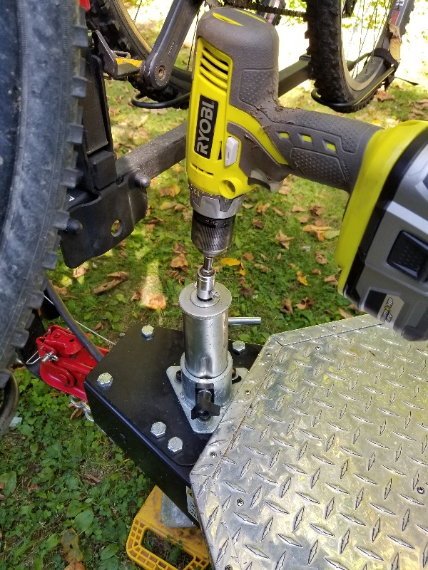

I know I am not the first to mention the Ultimate Jack but I thought other forum members might be interested in how I modified and use mine, especially since there have been recent jack discussions concerning accessing bike racks and tailgates, etc.
I purchased my Ultimate Jack a few months ago from Tractor Supply for around $70.  It is top wound and can be easily raised and lowered to various heights with the use of a sprung locking pin.  Although the manufacturer does not promote the complete removal of the jack, it can be accomplished by releasing a side bolt that protrudes into a vertical location groove.
As I hope is evident from my pictures, I removed the wind handle and replaced it with a 1/2" socket that I drilled to accept the existing nut and bolt (if necessary the handle can easily be reinstalled at anytime).  Not only does this allow me to wind the jack with my power drill, it also makes the jack more compact.  I also adapted the side channel release bolt with a large hand screw that allows me to quickly release and remove the jack without the need for a wrench.  Additionally, installation of the jack to my 320 tongue required some modification of one of the three jack bolt holes.
Since we carry our bikes using a hitch adapter, I can at any time quickly remove the jack, which means less risk of damaging the bikes and easier releasing/tilting of the bike rack to access the rear of my Trailhawk.  Previously, I was using the original jack modified to operate with the drill from the rear.  Although that worked, the Ultimate Jack is so much easier and gives complete reassurance, especially in tight turns.  Of course, when not transporting bikes, the UJ can be easily put in a raised position and left in place.
Incidentally, if any member could use my old jack (2018, 320) modified for drill use (I can set it for front or rear winding), they can have it for the cost of the shipping from NY.

    I modified an Ultimate Jack similarly by replacing the hand crank with a 1/2 nut (3/4” hex) welded on the shaft. This allowed the use with a Jack-it bike rack and use the 3/4” socket used with a cordless drill.

    Would you have needed to modify the base plate if you'd oriented the jack with the release pin facing the trailer?  Thank you for sharing this; I was unaware of this product.

    I positioned mine that way so I could retain access to the storage compartments under my deck.  However, even with the release pin at the front, I believe the plate would still require some small modification.

    I used the 1/2" socket so it would be easy to revert to the handle if ever needed.  However, welding a nut would have been easier.  Drilling through a chrome vanadium socket is tough and I busted 3 drill bits in the process!

    I carefully measured and with a junior hacksaw cut a small groove either side.  That allowed the drill to bite.  It took a while but worked out very well.  Not as difficult as you might think.

    @Marceline, the hole pattern is slightly different on the T@b (certainly with my 2018, 320), so one of the jack bolt holes has to be "stretched".  It's been a while, but I think I just used a drill step-bit, or possibly a small grinding wheel.  You could also use a round hand file.  Once the hole has been enlarged the jack fits perfectly.

    I finished installing a new Demco coupler and added an Ultimate Trailer Jack as part of the project. On our 2023 320s BD, there's a plate below the coupler with a hole that the BAL jack's tube just fits. I had to grind the hole 1/16" larger diameter to reuse it with the Ultimate jack. I also had to grind out one jack hole on the Demco coupler to get it one of the bolts to fit with it rotated 120 degrees from its normal positon with the pin mechanism facing toward the trailer. The aluminum platform and rail on our trailer intersects with the jack's pin lever, so I had to rotate it.
    I really like your idea to use a knob in place of the retention bolt for the jack's plastic tube guide. I wish the groove on the jack's outer tub didn't require removing the guide to allow full removal of the jack from its mount.

    The plastic tube guide serves no necessary purpose. Permanently removing it makes taking the jack on and off a very simple process. The only modification necessary to mount the Ultimate Jack on our 2020 320S was to grind a little off the tab opposite the pin so that it didn't contact the plate that's welded to the frame. I can have the Ultimate Jack pulled out and placed in the basket in less than a minute.
