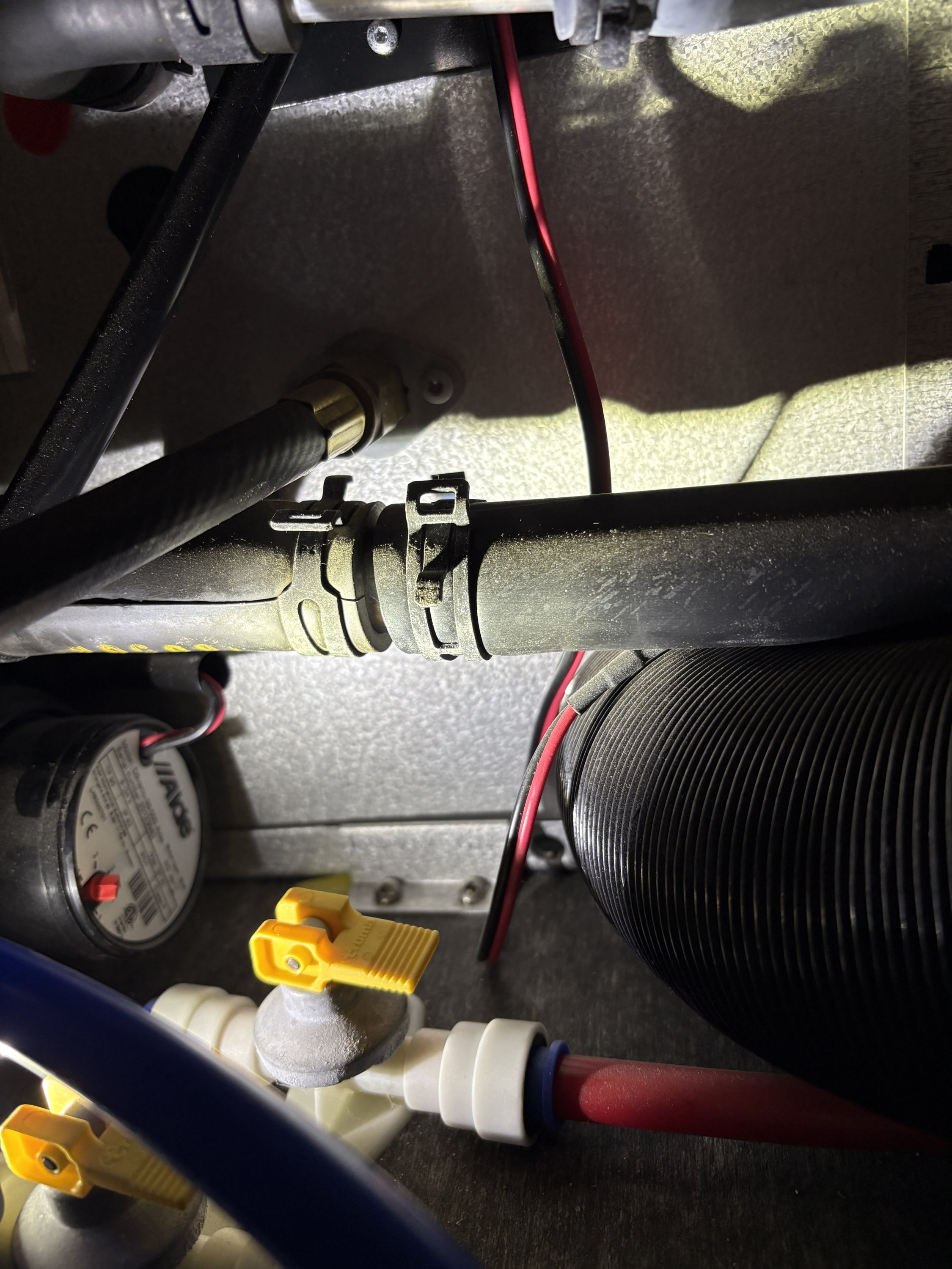

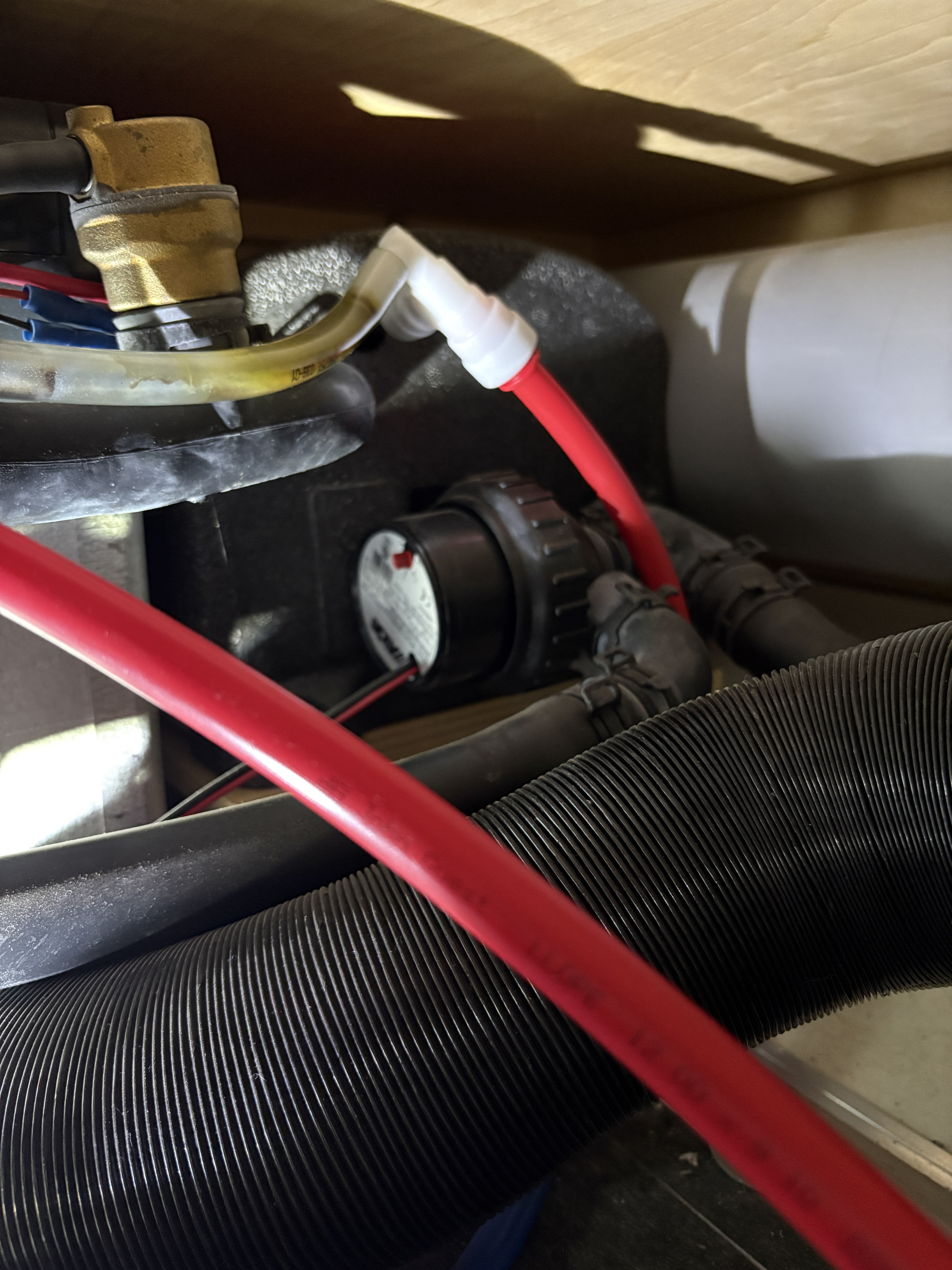

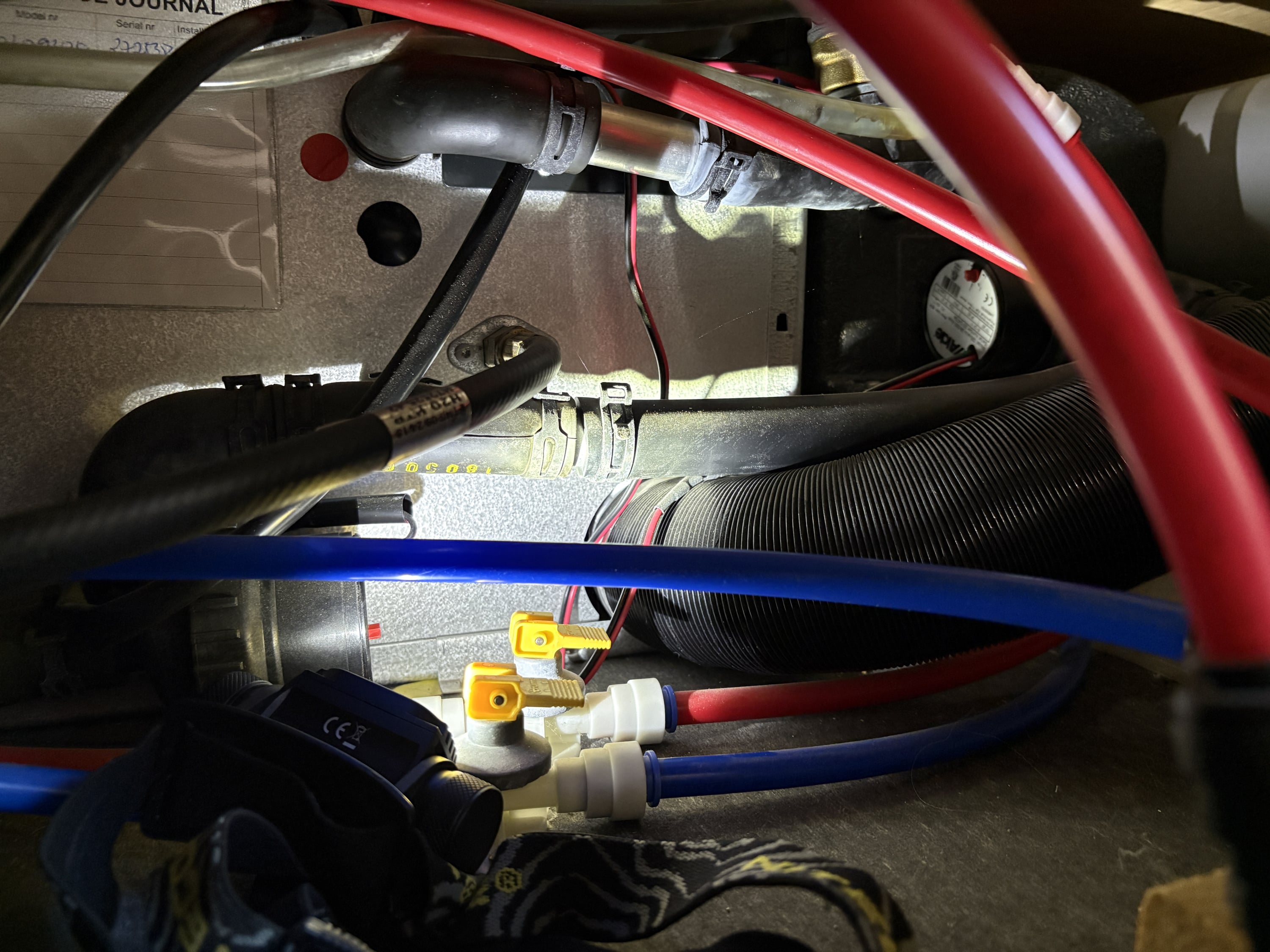

    Just did a distilled water flush and refill on my 2019 400 with Alde 3020 and Flow. I learned some shortcuts this time and the whole procedure was about 2 hours including the clean up.
    I updated the step by step that I use to make sure I don't miss something. It is attached.
    I did learn that the Flow pump only activates when the Alde calls for MAX hot water on the control panel. When doing the flush and refill the main pump is set to CONT and when the hot water is set to MAX the main pump stops and the Flow pump starts. I did this during the air purge of the loop just to ensure the new glycol went into the Flow loop.
    I did an informal look at my connectors for bulging and feel lucky to have seen none. My only mitigation was grounding the Alde and changing fluid about every 2 years. I stayed with the Century fluid.
    Here are a couple of pics of where the main Alde pump and the flow pump are located in my build
    Flow pump on R followed by both pumps with main pump on L followed by main pump showing setting dial
