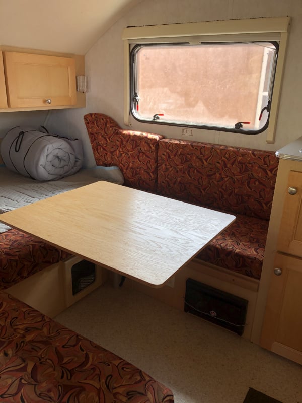

    I also made a custom table top that doubles as my queen bed support with the addition of one slat.  A pic of mine is attached, and i suppose if i'm getting rid of the queen bed setup i would probably re-make a table top that can act both as a nightstand and a table.  Any pics/dimensions/discussion of your table top would also be appreciated.
