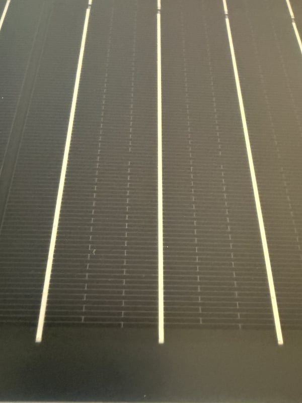

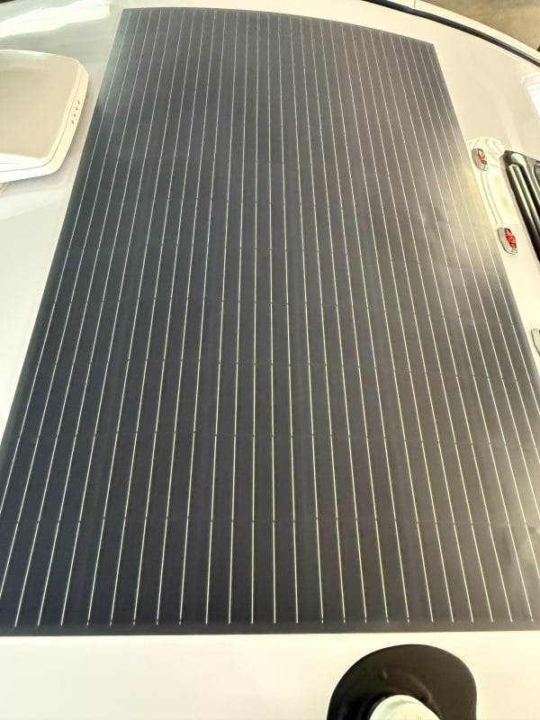

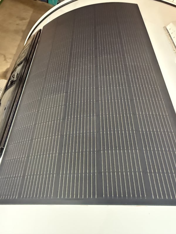

    Update on differing Sunflare Explor 310w solar panels . (finally got our 400 uncovered to prep it for travel) .
    So, we have a 2024 400 with the single 310w solar panel (on the rear) . Stock from the NuCamp factory , with a build date of early 2024 . Works ok ,  seemed to be diminished output since new, but NuCamp tested it and says it ok .
    While at the NuCamp factory for warranty work , I had them install the 2nd 310w solar panel on the front (Black Canyon upgrade) . This panel is brand new , as I got a message from NuCamp while my 400 was at the factory , that they just got a shipment of panels , and if I wanted it installed . Date - October 2025. Both 310w panels are controlled individually by 100/30 Victron smart solar controllers . Two Panels , Two Controllers .
    Right away , I could tell visually that the panels are different. Same size, but different.
    The new panel seems to be performing better , and also seems to be a higher VOC . Low 50's on the new panel , and high 40's on the old panel . This could be due to the age of the old panel vs a brand new panel , but Sunflair definitely updated the 310w panels . Other than physical size , the panels are distinctly different in how the panels were manufactured .
    Again , slight performance difference could be from age of the old 310w panel , or that the new 310w panel is actually better ? Will prob. never know !
    Here are some pictures of the old 310w panel vs the new 310w panel . Both Sunflare Explor 310w panels .
    1st TWO pictures are the OLD panel (early 2024) , 2nd TWO pictures are the new panel (10/25)
    OLD -
    OLD-
    NEW -
    NEW -
