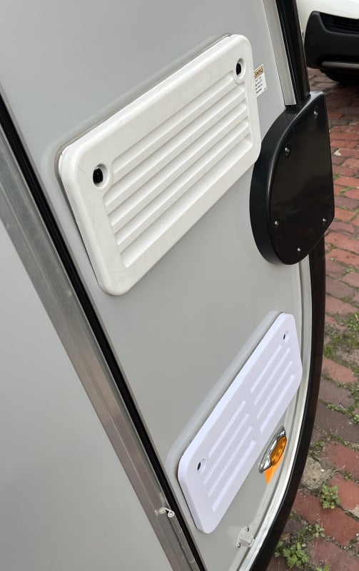

    Here is the finished product...

  • CherokeeCherokee Member Posts: 346
    These vents look much better when matched ! Now you have 6 fasteners holding them in-place. Hopefully, they have as much free area as the stock vents.Regardless, a little fan behind the top vent will improve air-flow.

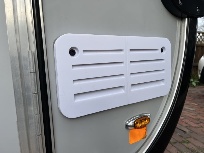

  • 3DPrintGuy2463DPrintGuy246 Member Posts: 5
    edited 1:19PM
    Hi! Im new here, and I recently reverse engineered the vent cover (for a 2018 NuCamp T@B 320 S) and 3D printed a test and it works great!
    If you're interested please let me know.
    The cover needs to be printed in 2 pieces, and glued together due to size limitations of my 3D printer.
    I can also print these in black. If you want a different color, let me know
    Heres what I would charge:
    Labor/Materials = $80 (+Shipping)
    Hardware included ("Speed nuts" and bolts, works with existing frame)
