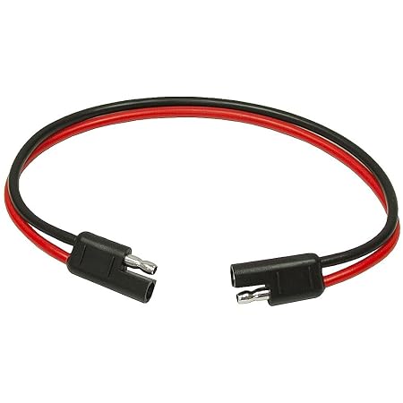

    @SAM re the adapter from Amazon, I have looked but been unable to find one there, suggestions on search terms (other than Zamp polarity reverser, adapter or cord) would be appreciated.
    Talula 2017 T@B Max S towed by 2010 Forester
  • Sharon_is_SAMSharon_is_SAM Administrator Posts: 9,873
    @RuthT, search Optimate Cable 0-27.  It should take you there.
  • Michigan_MikeMichigan_Mike Member Posts: 2,861
    edited August 2017
    This is what you are looking for and will get you to other different wire size "quick disconnect" style SAE connectors.  These quick disconnect adapters can be purchased at any local auto parts stores and Walmart or places like Lowe's might have them too.  No doubt you should be able to match the size of the solar panel wires you are looking to splice out and adapt to and to adapt easily to your needs.   the quick disconnect referenced is for a 10 gauge wire and you may be looking for something smaller, depending on the leads you currently have for your solar panel.
    Image result for Pro Trucker 2 Pin Quick Disconnect Wire Harness SAE Connector Bullet Lead Cable
  • RuthTRuthT Member Posts: 6
    Thanks much @Mike, managed to finally find one and have the tender set up and charging the battery now.
