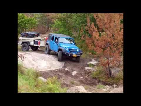

    An old friend of mine did some gnarly stuff with his off road trailer.
    https://www.youtube.com/watch?v=PDYhGZdeWB8
    2016 T@b 320 CS-S - 2018 GMC Sierra - St. Catharines, Ontario, Canada

    @rkj__, is that Georgian Bay in the video? Nuts!

  • rkj__
    rkj__ Member Posts: 641
    I was not on the trip that footage is from, but I believe it is all from Ardbeg Ontario, near Black Lake and Round Lake.

  • ChanW
    ChanW Member Posts: 3,165
    Ah... The rocks looked familiar to me.
    We spent a lot of time up in that area, near Killbear Park.
    Beautiful country.
