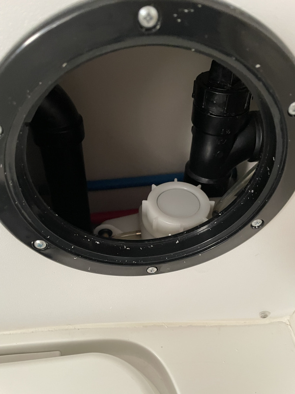

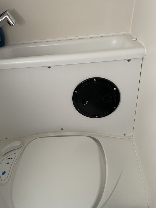

    I added an access hole to make it easier to monitor the fluid level. This was a suggestion by one of the contributors to our forum.

  • Horigan
    Horigan Member Posts: 926
    Excellent.  Keep monitoring the level as needing 1.5 quarts would indicate there's a leak somewhere...
