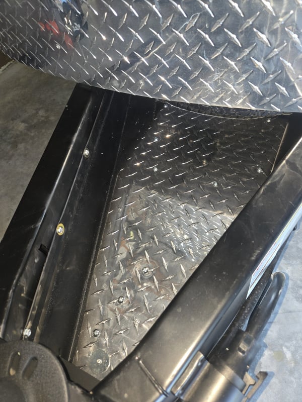

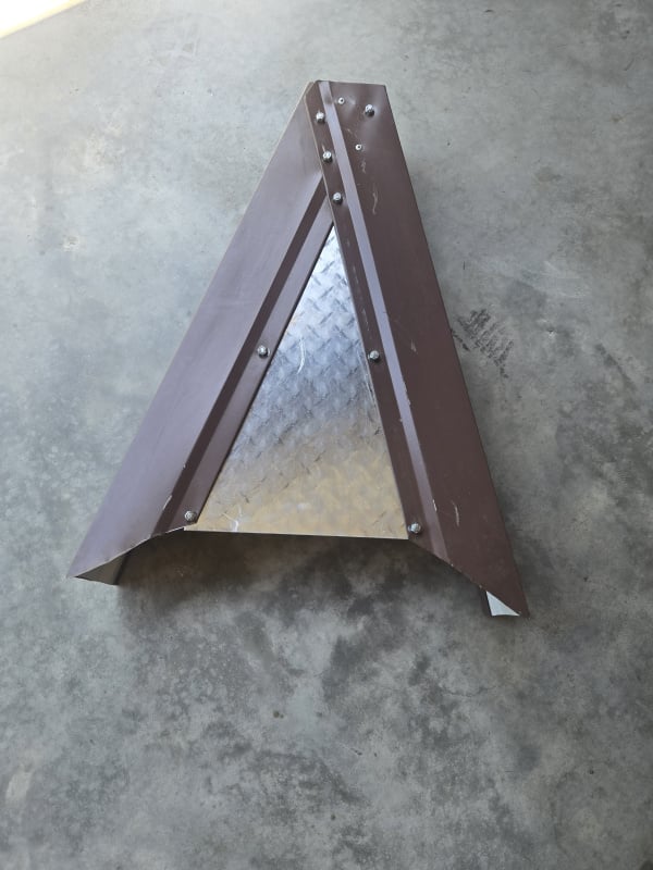

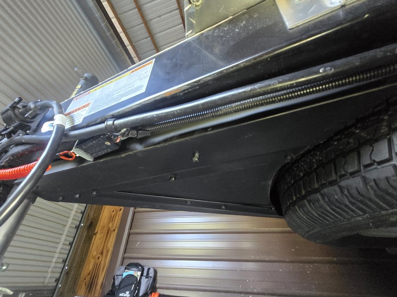

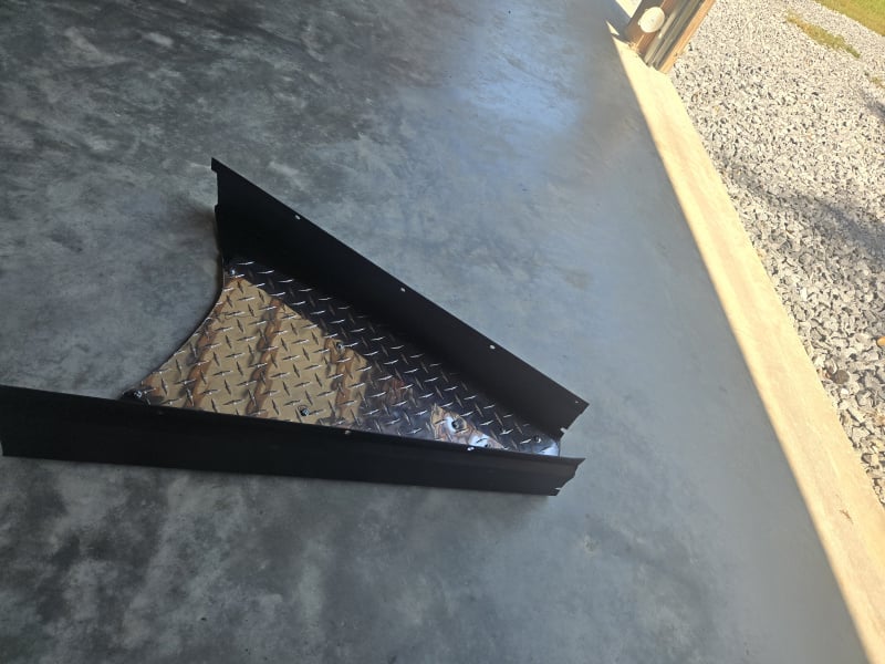

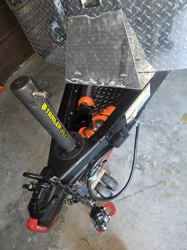

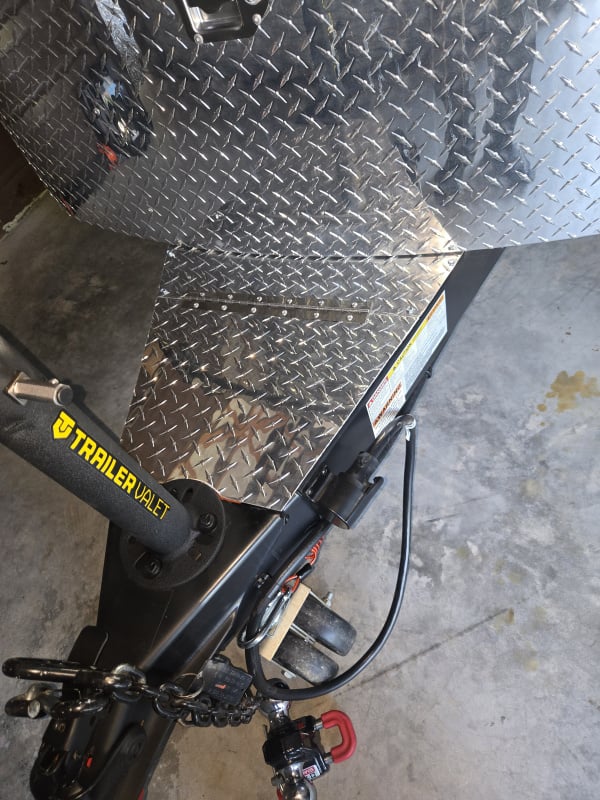

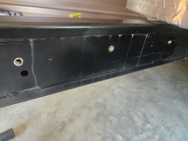

Just recently purchased a 2025 Tab 320 Boondock Black Canyon with the upgraded Dual battle Born lithium upgrade package and your storage mod was a must do, lol . I had to purchase 3 of the 1x2 foot diamond tread aluminum panels from Home Depot and darn they are expensive at $54 each ! I had the other odd pieces at home that I pieced together to make the box hang 1.25" deeper below the tongue frame. A 4' piece of corner trim left over from my metal garage made the side panels pretty easy to construct. I used RivNuts to attach to the frame and the spare tire under the tongue give it a pretty good back plate as I will never put anything in there small enough to slip through the gap. Thaks for sharing your design. It's going to work out very nice.
