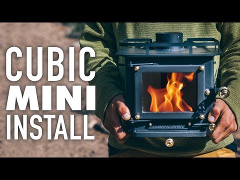

    I love the Alde, but this would look pretty if I could find a place to put it for extended winter camping...
       https://youtu.be/zzq2MlX8kRo
