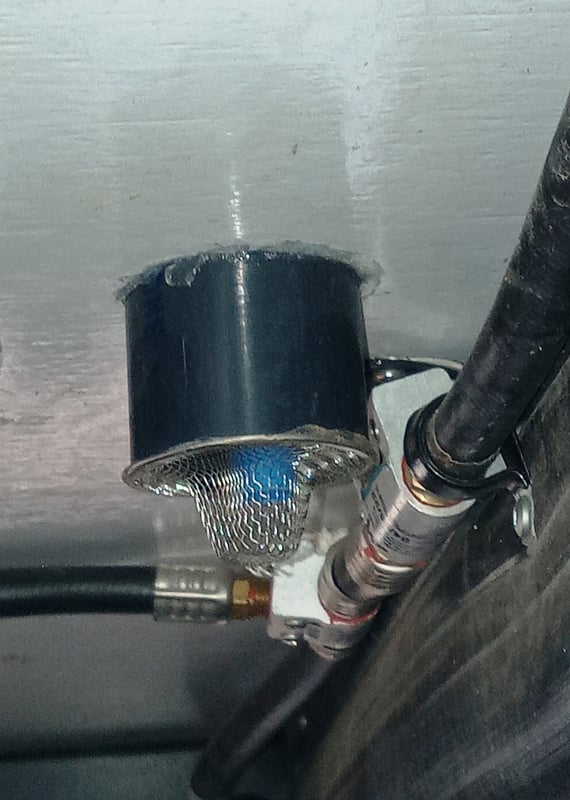

    I have not installed it yet, but here is the screen for the overflow we plan on using... We purchased @ Home Depot- think it was in the faucet area versus the plumbing area... For installation I was thinking of either stapling it (with some heavy duty staples) or using 3 fairly short/flat head screws-  It is about 2-1/8 diameter... I am wondering if the mesh may be a little on the too tight side - but I can easily rinse any grime out before filling- and after all it is designed to let water through while blocking "stuff"- I do not recall the price but I think it was around $3.00...
    For our Alde heat vent cover - we're using this Camco product I found on Amazon here... (4.5" diameter) for about $10.
    It did not fit as a square, but almost perfectly fits as a diamond. I wired it on using the posts on the Alde and wrapping the wire through- It just made about 400 miles without budging. I will need to keep an eye on it in the winter to prevent ice blockage (can always remove in the winter).

    Hey Folks - here's the picture of the overflow tube strainer installed - I used 4 short lathe screws - seems to be on there pretty good. I think this is a good fit - will monitor and see how it holds up to the road, grime, etc...

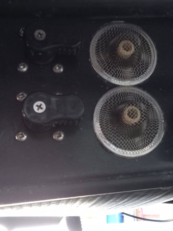

    I decided to make some preventive screens for my 2023 320s's drain/vent pipes. The drains for cold, hot, and fresh water all stick out through thick steel plate on our trailer, so I picked up a package of six sink strainers from Amazon and epoxied four thin rare earth magnets to the underside of each.
    Link to strainers https://www.amazon.com/gp/product/B0C59L883G/ref=ppx_yo_dt_b_search_asin_title?ie=UTF8&psc=1
    Link to magnets
    https://www.amazon.com/gp/product/B01NAL9I5H/ref=ppx_yo_dt_b_search_asin_title?ie=UTF8&psc=1
    I used JB Weld epoxy to glue four magnets to each screen.
    I put a dab of epoxy on top of each magnet, set the screen on the magnets, and then put a dab of epoxy on the screen above each magnet.
    Here's how the screens look stuck over the hot and cold water drains on our 2023. I put another screen on the fresh water drain on the other side of the trailer.

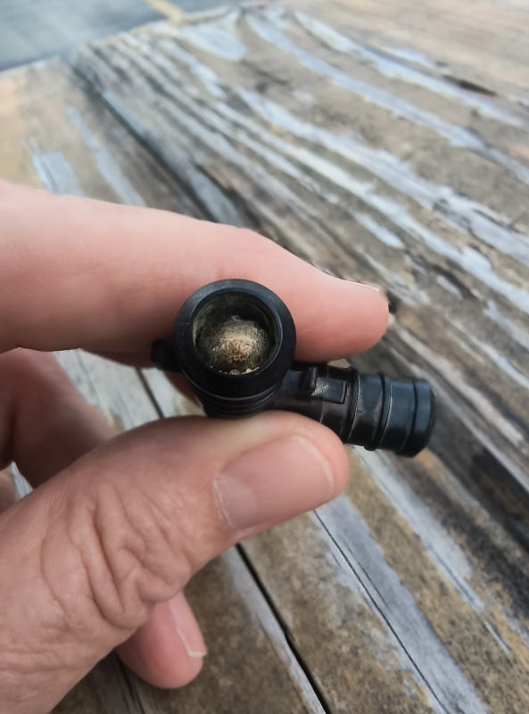

    Another member suggested using these drain screens to cover the open drains and vents.  I used their idea in several places.  A little ShoGoo around the edges and just stick in place.  I made an easy extension with a light duty piece of plastic tube for the longer overflow vent.
    Here's a couple photos and a link.
    https://www.amazon.com/dp/B0CQ772FK1?ref_=ppx_hzsearch_conn_dt_b_fed_asin_title_1&th=1
