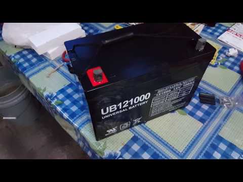

    I linked this one higher in the thread:  Universal Power Group makes many batteries for dozens of different applications.  A Group 27 100AH battery.
    It is a decent price, and literally has been around for years.  There are reviews going back to 2016 on this battery. They have good warranty and return policy.
