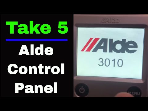

    @Buckster, take a look at this video.  It should help provide the basics.  There are other similar videos on YouTube.  I haven't watched this one recently, but a quick look indicates it probably covers what you need to get a general understanding of the display panel operation.  The screenshot below says "Alde 3010," but it is the same/similar for the "3020," although the 3020 has the "gear" icon as referenced by @Michigan_Mike, whereas on the video it is a "wrench" icon.  (Actually, I did not realize the 3010 ever had a digital display, so I learned something new.)
    https://www.youtube.com/watch?v=3HwuMlV6w1k&list=PLfZJCAV6SX_idezI1n3iUfRjjAJhW9pcS&index=4
    Here's another video:
    https://www.youtube.com/watch?v=4LzqMLF1lZk
