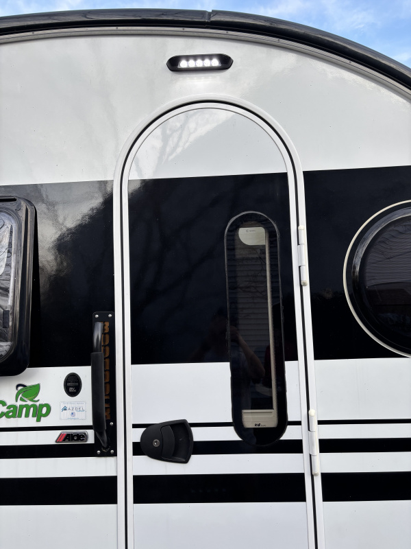

I think I will check the width of the mounting screws and see if I can match a RV Porch light that lines up with the holes. I've see ones that are dimmable on Amazon, so there may be other choices out there....Unless someone has done this already and can provide us with some details....please :-)

I will be ether replacing mine or replacing the gasket with something else cut to size. Don't care about the original holes as long as the new light covers the old holes. I'll just fill them with epoxy.

@Rodent77 thank you for contacting the manufacturer. Our 2022 Tab 320S BD has that black streaking from the porch light, too. Nucamp sent a replacement light but I do not want to bother putting it up if it will have the same problem. Looking forward to what you find out. Thanks again!
Any chance you can take a picture of the gasket? Just curious of thickness and shape before I remove the light. I plan just to make my own gasket out of silicone rubber or foam. Sounds like the light folks either didn't get what they asked for or specked out the wrong stuff.

@Yoshi_TAB there's a slight ridge all around the gasket which the black plastic housing fits into. I forgot to mention that no screws came with the replacement light. The white wire is marked negative and the black wire is marked positive.

The strips are 2 inches x 36 inches x 3/16 in thick. They have different widths and thickness available. 3' more than I need but will fashion a template of existing gasket and cut a new gasket during the winter months. Rewiring will require further research.
The part number for our 2023 trailer is 69711F-BK-AM. BK is for a black shell and AM is for amber LEDs. I just bought a two-pack of 69711F-CH-3K (chrome and 3000K white LEDs) for $15 from trailerfix on eBay.
The mounting screws are square drive. NuCamp used a very stiff sealant (probably styrene-butadiene like Shoe Goo) to mount the light and seal the hole for the wires. That makes it very difficult to pry the sealant loose enough from the wires to pull them through the hole. The fixture's gasket appears to be natural rubber, and it's not really the kind of gasket someone could craft (well) from rubber sheet. It's precision molded to fit a groove in the light assembly, and there's a raised rim around the outside shell for the light. There's white RTV sealing where the wires pass through the gasket, so replacing the gasket will mean removing the fixture's rtv and, of course, pulling the wires out through the wall. You can access the hole for the porch light and its wires by unscrewing the inside control panel. In our trailer, the thin wires for the porch light are crimped to heavier wires. The ground wire connects to a bus bar in that compartment and the positive wire connects the rocker switch for the light. To pull the fixture's wires free, I'll have to undo the butt connector crimps to the heavier wires inside.
There are many protectants and dressings for rubber and I treated the exposed edge with expensive 303 rubber protectant, but the edge is still eroding. I'm inclined to try painting the gasket with a rubberized paint like Plasti-Dip to prevent the rot.
Note the molded groove and raised rim of the gasket.
If you want to try and find a similar size light, this drawing with dimensions is from the ITC product page.
I bought a couple of these lights (chrome with white diodes) from ebay for about $15. Our 2023 trailer has a black shell with amber diodes. I removed the white silicone sealant to remove one of the gaskets and painted the edges with clear Flex Seal Liquid. But I decided to try and use the gasket already in place on the existing fixture. I removed the fixture and cleaned the eroded edge of the gasket with isopropyl alcohol. I also removed the residue of the stickers that were stuck to the gasket and the trailer wall.
Here's what the molded gasket looks like (with the sealant painted on):
After going through all this, I'd advise leaving the porch light installed and clean the exposed black gasket with alcohol until you you don't get a lot of black on the cleaning cloth. Then use a small brush to paint a sealant onto the rubber. A clear sealant would be a lot easier to apply with good looking results than a black one would. I don't know how well my choice of sealant will work over time. Right now the trailer is covered, so the proof will come after some months of exposure. All the black staining came from the thin exposed edge of the rubber. The unexposed rubber showed no signs of oxidation or erosion.
I cleaned the gasket off as best I could although it still would leave a black streak on the rag no matter how much I wiped. Then I covered it with a couple of coats of clear Polycrylic. I'll see if that holds up next season....
Just a follow up. I never really thought about this again until this Spring as we got ready to hit the road. I looked up at the light and thought "I can see the Polycrylic around the edge I coated - Oh! and no black streaks". It has a bit different sheen at the right angle in bright sun. A bit visable at the lower left end of the light. Seems to be solving the problem so far. I did notice the black gasket around the wheel well trim does the same thing to cleaning rags. It just doesn't drip down the trailer side...
