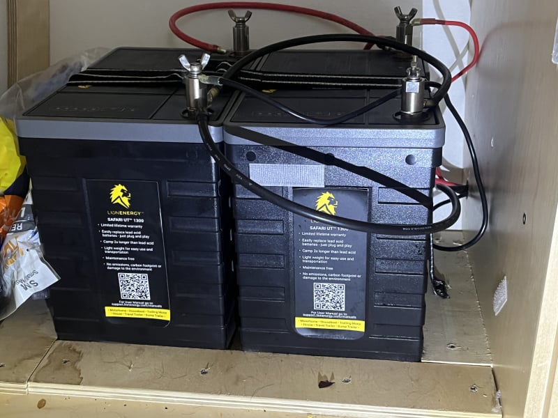

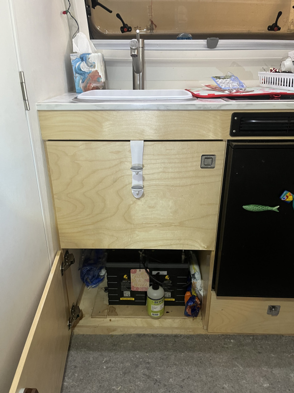

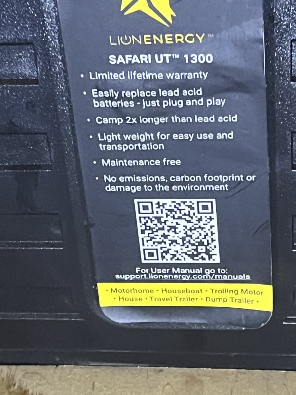

    I have the newer fridge that only runs on electric.  I don't think I have a shunt.  (Not really great at this electricity stuff.)  I have a victron app that can see whatever the NuCamp installed Solar Controller puts out, which I mostly use to see how many amps are coming in off solar, but when it comes to figuring out the state of charge of the batteries, I just push some button on the Lion Safari batteries that has some sort of idiot lights on top of them that shows state of charge wherein 5 lights - full charge and 0 lit up would be zero, and there are 5 lights total on each battery.  So if you get down to say 1 or 2 lit up on each battery, you are in danger of running out of power.  I am attaching a snapshot of the app output after I turned off the electric heat I have running off shore power in my garage right now to dry the cabin out after our last trip.  Obviously there is no solar input because the 320S is inside the closed garage.

    The way the solar controller is installed in the T@b (and pretty much all RVs) is that it only connects the solar panel and the battery, the load terminals are not connected. The loads (lights, fridge, TV etc.) connect directly to the battery (via the fuses) so the solar controller is in the dark (see what I did there ? ;) ) about how much current flows out of the battery. Hence the load output is always zero and it doesn't help with troubleshooting. Depending on the exact model of battery it might have bluetooth monitoring which can give you a pretty good reading of actual current draw.

    That makes sense.  The batteries I have are pretty good, but just a bit too old for the direct monitoring via the bluetooth app that comes with the newer ones.  All I really have are the idiot lights, but that's ok.  I somehow estimated that the refrigerator could draw up to 1.8 amps, which over a few days can wipe out a lot of my 200 amp-hour capacity if not replenished in some way.  Normally not an issue, but I think just not using the fridge if I can avoid it and shutting down the who master switch are the keys to my plan of attack now if there is not enough solar.  If I try to rewire a bunch of stuff or switch out the Jenson and so on I'll end up screwing it all up and then I'll really be in a bind.  Thanks again for the tips.

    If you have a Victron controller, that monitor is lightyears better than any of the bluetooth "monitors" in the batteries, especially if your Lion batteries are "old" as you say.  The way that lithium battery voltages "drop" make any "blinky light" display or even various voltage readings very misleading.
    The best investment to make to sort this out would be a Victron shunt.  This would simply remove any question about "is 13.2 volts 70 percent of capacity or 30 percent capacity" of my lithium battery.
    The shunt will give you much more and better information about exactly where your batteries are.
    The next thing we should look at is the setup of your Victron solar controller.  If you are not very familiar with the workings and readouts of the Victron devices, we should have a look at them with you and make sure your solar setup is correctly set up for charging a lithium battery.  Show us the setup page.

    If you do a lot of camping without shore power, I recommend that you consider installing the Victron SmartShunt. It measures all power going in/out of your battery, removing the guesswork. I have an older Lion Energy battery with the idiot lights and they aren't really that useful. If your battery is in the tub at the front of the trailer, it would probably be better to get the IP65 (more waterproof) version. The 300A version of either shunt is fine for a T@B.
