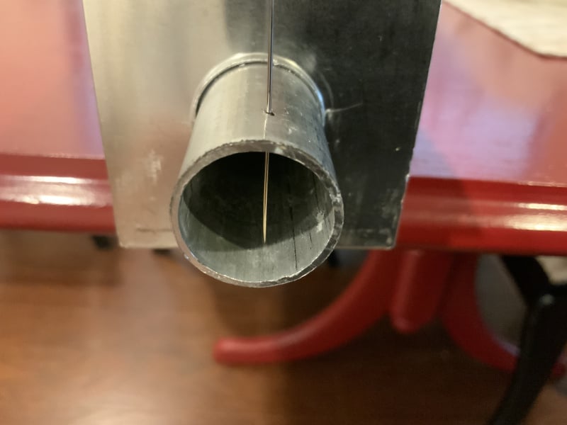

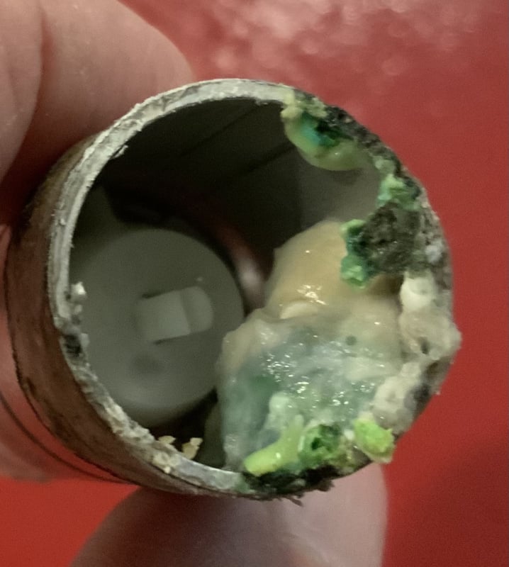

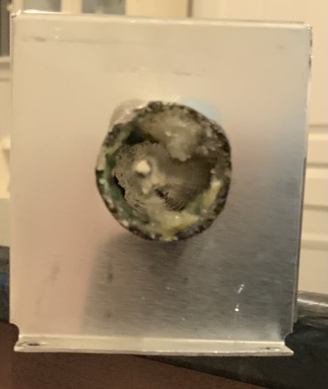

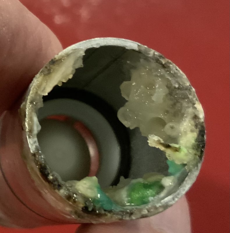

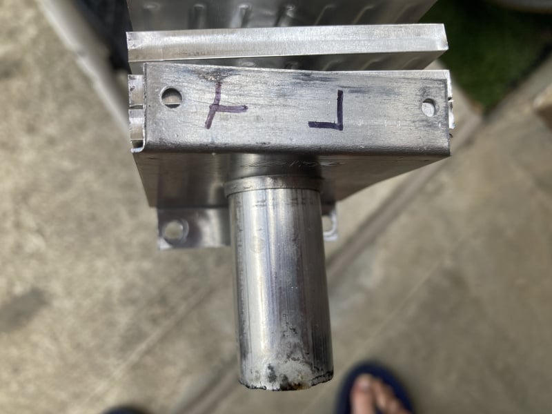

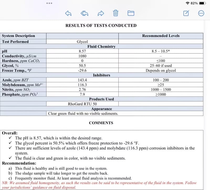

    Sharing what my experience has been after my first  system flush to change from Century to Rhomar, and 2 additional flushes (Rhomar to Rhomar) both after 2 years.  I found the pH analysis to be misleading at best, and confirmed my suspicions by sending a 16 ounce sample of Rhomar fluid drained from my second system flush to Rhomar Water for their analysis.
    Here is their analysis of my 2 year old Rhomar fluid:
    That analysis resulted in this degree of corrosion:
    I am not a chemist, engineer or scientist, so I have no explanation for what is happening in the Alde system. Only an opinion based on my experiences, what you cannot see may be a big problem later, do what you feel comfortable with to fight corrosion. Do  I think there is an issue with Rhomar fluid, yes, do I know what it is, no.  I will leave that for people smarter than me to figure out.

    @Freespirit So you had issues with the Rhomar water? It seems the vast majority of users had issues with Century but I haven’t heard much about Rhomar. I’m coming up on year 3 of not changing my fluid (I did perform a fluid swap after two years of ownership though). I do a visual check of the convectors and they look fine but who knows what could be going on inside the piping.

  • Freespirit
    Freespirit Member Posts: 187
    @manyman297, I had no issue with the Rhomar water, my Rhomar was within their specifications after 2 years of use. All which adds to the continued discussion, “why are so many Alde systems developing corrosion after following manufacture maintenance recommendations”.

  • ckjs
    ckjs Member Posts: 143
    The Nitrate and Phosphate levels are way down from the original specification! I’m don’t have the chemistry to assess that, but I’m  surprised that the now-trace amounts of those are considered still okay.

  • otr_320
    otr_320 Member Posts: 80
    edited April 7
    ckjs said:
    OP's Rhomar test results indicate 2.76 ppm of Nitrite and 7.9 ppm of phosphate.
    AI response:
    "Based on standard industrial water treatment practices for glycol-based heating systems, 3 ppm of NO2 (Nitrite) and 8 ppm of PO2 (Phosphate) indicate that the corrosion inhibitor package is severely depleted or nearly non-existent. This poses a significant risk of corrosion and damage, particularly for aluminum components, which are highly sensitive to corrosion in untreated or incorrectly treated glycol.
    Nitrite and phosphate levels in glycol-based heating systems drop to low levels primarily due to system leakage, biological degradation (nitrite-reducing bacteria), or chemical depletion caused by acid formation from glycol degradation. These inhibitors are consumed over time by excessive oxygen, high temperatures, or contamination, reducing their concentration
    Rhomar's "Recommendation" (in the comment section) says "This fluid is healthy and is still good to use in the system".  It says this even though the test results indicate the Nitrite and Phosphate levels are significantly below the "Recommended Levels" of 1000-1500 for Nitrite and >=1000 for Phosphate.
    The AI response and the Rhomar "numbers" appear to paint an ominous picture.  The corroded pipes in the OP's pics are most definitely ominous.
