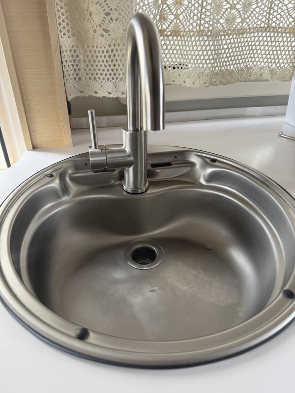

Finally got around to changing the stock faucet in our 2019 400. I have to amplify and thank all for this mod. I think this is the most functional change we have made since we got the trailer. My original faucet was on pretty tight, and even with just a plastic nut it was hard to reach, but with some work it came out.ChrisFix said:@qhumberd
You'll also need to adapt the water supply lines provided with the faucet to the 1/2" water fittings from the T@B.
This or something like it should do the trick:
https://www.amazon.com/Faucet-Adapter-WEWE-Fittings-Connector/dp/B08VRPYWLM?source=ps-sl-shoppingads-lpcontext&ref_=fplfs&psc=1&smid=A3HDYWGVCBF05F
The install of this new faucet, with the adapters from @ChrisFix made the job very easy. It all folds and fits beneath the glass cover no problem. As cheap as this replacement is, I wonder why they don't make it standard?
Thanks all!!2019 T@B 400 Boondock Lite towed by 2016 5.7L Toyota Tundra

This is the faucet we used for our '21 Tab 320:MountainMade said:I’m in a 2020 320s Boondock Edge. Any suggestions?
https://www.amazon.com/gp/product/B092YSBW7X/ref=ppx_yo_dt_b_search_asin_title?ie=UTF8&th=1
This was a huge improvement over the stock faucet.
I just installed this faucet! My wife couldn't be more happier! The change over the stock one is amazing!
Thank you!
Tab 320s Boondock 2022 | Jeep JKU 2017
Mods: MaxxAir 7500S | 2x 100Ah LiFePo4 | Victron MPPT 75/15 | Ultimate Trailer Jack0 -

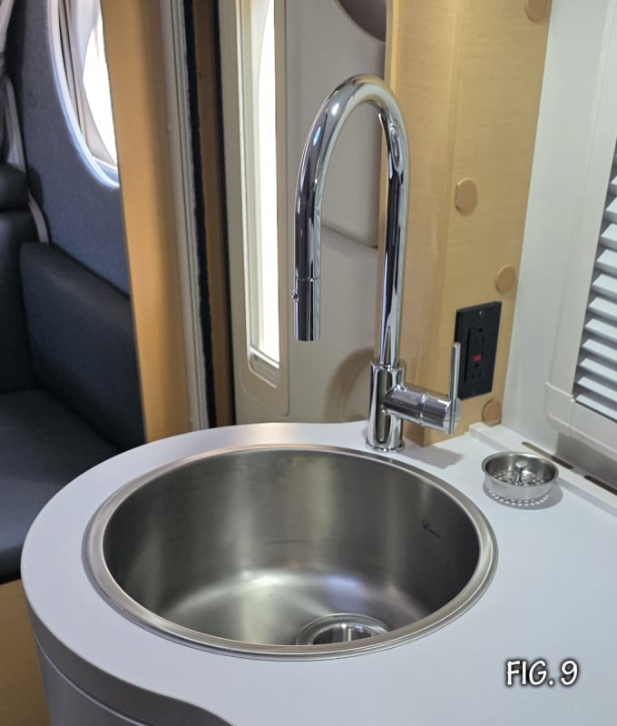

I am reviving this thread as it appears this faucet is no longer available at least with Amazon. Also, though we love ours, the upright seems to have gotten loose and wants to fall forward now. Anyone se a way to tight up the up and down rotation?
That looks great! 🙌 It must have been a bear to work in the small space where you added the faucet!
I added a new faucet last month but I haven’t changed the sink out so the fix is not quite there yet.
I will eventually install a different sink.
Could you send a link for your sink?Wander Yonder….

@EPOD1 Thanks for that:
I went through this once already and found the "one that fits" is actually poorly made and I still had that shallow sink and glass top to deal with.
The deeper sink is a bit more than I want to tackle at present, though I see the very real benefit. A deep sink with a cutting board cutter and a pull down faucet like you have looks ideal.
Thanks
I like the cutting board . Where did you get it ?
2025 400 Boondock Black Canyon0 -
Link to the sink:
Link to my install:
Honestly, it was pretty easy.
And Everyone loves it now, it actually a real sink.
