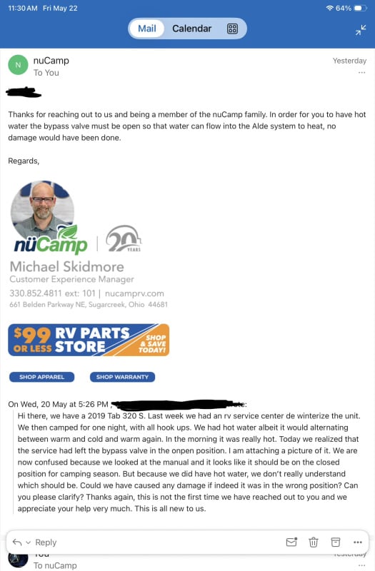

We were confused so we called customer service. They said the valve should be in the “open” position to allow water to flow into the Alde tank. Again, this is opposite to what the manual says. Has anyone experienced this? Is the manual wrong? I’m attaching a picture of my system and the picture shown in the manual.
we are new to this and we don’t want to cause any damage.

  • this is the email exchange with Nucamp

  • Warning: Sarcasm follows….
    You got an answer from a "Customer Experience Manager" and a quick google search shows his background is in sales and marketing, including a stint as an account rep for Kellogs.
    To be fair a total of three valves need to be changed to switch between winterizing and camping. He is correct that the valves to and from the Alde need to be open to have hot water, but the bypass valve needs to be closed.

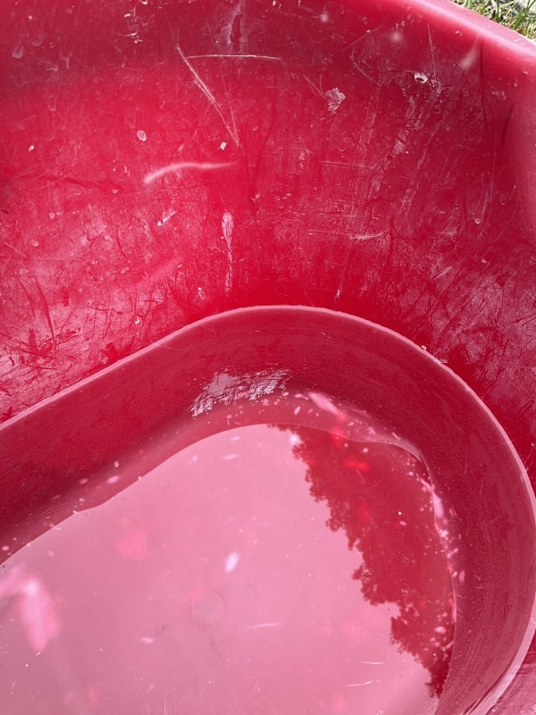

  • @Bayliss I checked again how much water came out of the Alde. I put a bucket under the Alde drain, opened the yellow flapper and collected the water. What came out was about 5L which is a bit over a gallon. What are your thoughts?

    @Voyager, I'm not sure what to think, because 1 gallon is just under what the Alde tank holds (approx. 2.2 gallons, I believe). Before doing that, did you feel that the Alde tank was likely full (i.e., you went through the process to fill the Alde tank and pressurized the water lines)?
    If so, if I were troubleshooting this, I would next put the bucket back under the yellow flapper. Open the hot an cold water valves all the way at your kitchen sink and then open the yellow flapper valve to see if any more water drains out. IF there was a full tank, and you only got 1/2 to drain using the yellow flapper alone, maybe opening the valves at the sink will reduce any vacuum present and increase the flow, emptying the rest of the tank. Worth a try.

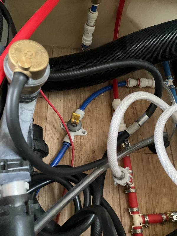

  • @MuttonChops , I think we have a different mixing valve. Can you kindly please confirm? Are the connections correct? Thank you.

    @Voyager, it looks like you have the "Speedfit Thermostatic Mixing Valve" (TMV), which Truma-Alde started using with newer systems. I am surprised that you have it on a 2019 320 S, because the mixing valve on my 2019 320 S (and I am guessing on @MuttonChops' 2018 320 S as well) is different.
    See this discussion thread for some helpful info, BUT be sure to read the corrected/updated info in the first post re how to adjust the valve:

  • @Voyager I agree with @Bayliss that it appears an earlier owner replaced the original TMV [black cap LK550] with the newer Adle Branded [red cap] TMV . . . most likely because the LK550 needed maintenance.
    The newer TMV includes a screen filter on the cold water input side.
    Several owners have reported the screen being clogged, retricting or stopping water flow.
    The Alde TMV appears to be a cheaper (IMHO) re-branded Cash Acme HG110-HX unit which has far less web-available information than the LK550. At this time no TAB owner has provided an overview of the unit at a level near/equal/better then the LK550 Document in our resources section.
    That said . . . basic operation and parts are similar to the LK550 with the addition of that Screen Filter and perhaps some flow direction check-valve parts.
