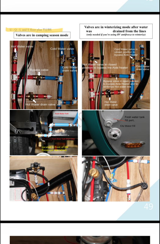

Confused with the position of the Alde bypass valve 2019 Tab 320 S
hello everyone, we purchased a used 2019 tab 320 S. The dealer de winterized it and we camped for one night to test all systems. We had full hook ups. Water was coming out hot at times, albeit fluctuating…….. When we got home, we noticed that the Alde Bypass valve was in the “open” position (parallel to the lines). This is the opposite of what the photos in the manual show for camping season mode. But we did have hot water.
We were confused so we called customer service. They said the valve should be in the “open” position to allow water to flow into the Alde tank. Again, this is opposite to what the manual says. Has anyone experienced this? Is the manual wrong? I’m attaching a picture of my system and the picture shown in the manual.
we are new to this and we don’t want to cause any damage.

    When you said the hot water was "fluctuating", that was the basic clue back in the day that the "Bypass" valve was open. Owners would have hot water for a few seconds, then cold water for a while, then a little more hot water, etc. Maybe a factor here is you being on city water, and the extra flow from that connection made a difference.
    You are correct: that "bypass" should be closed. The actual duty of "preventing sanitizing or winterizing solutions from getting to the Alde hot water tank" is performed by the two valves on the hot and cold lines heading into the Alde.
    The"bypass", when open, simply allows those liquids you want to keep out of the Alde to circulate properly around the plumbing back to the faucets.
    So, try this for yourself, while using water from the fresh water tank and the pump, with the Bypass Valve "open". I bet you get the "fluctuating" water situation.

    thank you @pthomas745 for your quick response. We just tried closing the valve (perpendicular to the lines) and we did not have water in the hot line at the faucet. So, at least in this particular camper, the bypass valve should stay in the open position during camping season (contrary to what the manual shows). Thanks again!

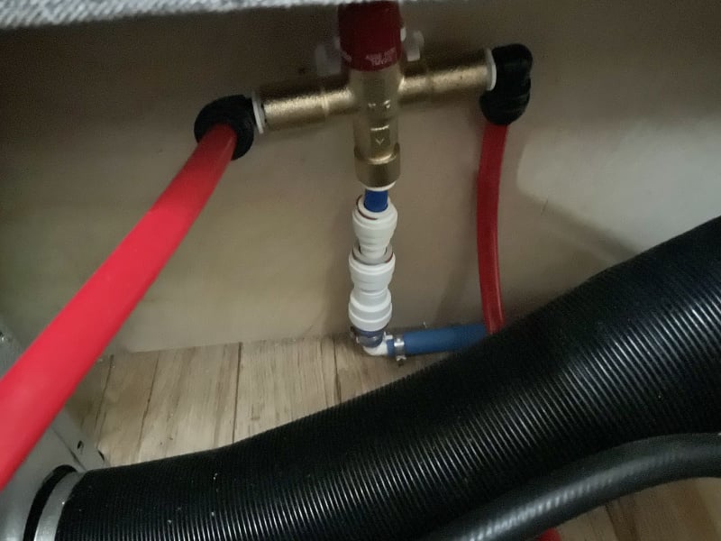

    @Voyager , Sorry, but you are incorrect as the ByPass-Valve Must Be Closed for camping season to get real Hot Water for more than a few seconds.
    Assuming the first picture you posted is your TAB:
    Considering your TAB is a yr-2019 . . . the most common reason for no hot water is the TMV mixing value is clogged, jammed and needs to be serviced. Every few years the TMV should be cleaned and lubricated Something That Is Not Covered in any of the nuCamp manuals.

    Thank you for responding, when we close the bypass valve no water comes out of the hot water faucet. That is indeed the photo of my camper. Nucamp customer support said it should be open. I will however review the mixing valve and try again. Thanks for the link.

    @Voyager , I agree with @MuttonChops. I think nuCamp Customer Support may be misinterpreting what you are experiencing.
    I may be misunderstanding what is going on as well, BUT, before you do any adjusting to the mixing valve, is it possible that your Alde hot water tank is not filled (because the bypass valve remaining open is not allowing sufficient water to flow through the cold water line to fill the tank?).
    To find out, close the bypass valve, but leave all the other valves set as depicted in the photo posted by @MuttonChops. Then, connect a fresh water hose (with pressure regulator attached) to the fresh water inlet on the side of the trailer. Turn on the hose to energize/pressurize the water lines and fill the Alde tank. You don't necessarily need to turn the hose on full blast, at least initially, but sufficiently enough to pressurize the water lines.
    To allow the water to be pulled into the Alde tank, open the cold and hot water faucets at your kitchen sink, just a bit, to bleed/pull the air out of the water lines, which should in turn allow the water to start flowing through the lines to the faucet.
    Gradually further open the cold and/or hot water valves at the sink to increase the amount of air and water flow as the water lines fully pressurize. Once the "sputtering" stops, and you have a constant/smooth flow of water running through the faucet, your Alde tank should be filled. You will probably need to open the shower and toilet valves too to get water flowing through those lines as well.
    If all goes well, and your Alde tank is full and the water lines pressurized, it should just be a matter of heating the water in the Alde tank to see if hot water starts flowing at a good temp.

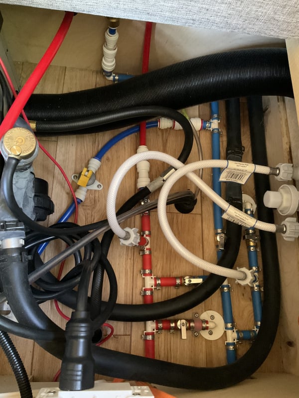

    @Bayliss I checked again how much water came out of the Alde. I put a bucket under the Alde drain, opened the yellow flapper and collected the water. What came out was about 5L which is a bit over a gallon. What are your thoughts?

    @Voyager, I'm not sure what to think, because 1 gallon is just under what the Alde tank holds (approx. 2.2 gallons, I believe). Before doing that, did you feel that the Alde tank was likely full (i.e., you went through the process to fill the Alde tank and pressurized the water lines)?
    If so, if I were troubleshooting this, I would next put the bucket back under the yellow flapper. Open the hot an cold water valves all the way at your kitchen sink and then open the yellow flapper valve to see if any more water drains out. IF there was a full tank, and you only got 1/2 to drain using the yellow flapper alone, maybe opening the valves at the sink will reduce any vacuum present and increase the flow, emptying the rest of the tank. Worth a try.
    FWIW, I recall some past discussion by @ScottG (who may chime in) regarding the fact that opening the cold water low-point drain valve can also drain the Alde hot water tank. Again, draining the low point drains (hot or cold), such as when winterizing or sanitizing the plumbing system, is more efficient if you open the valves at the sink (I also open the shower valves) to help release any vacuum that may be present in the water lines. This won't necessarily help resolve whether the Alde tank still has water in it. However, if more than a gallon comes out, that would likely be a good indicator that most of the water came from the Alde tank. If nothing else, just good info to know.

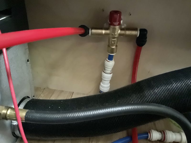

  • Voyager
    Voyager Member Posts: 63
    @MuttonChops , I think we have a different mixing valve. Can you kindly please confirm? Are the connections correct? Thank you.

    @Voyager, it looks like you have the "Speedfit Thermostatic Mixing Valve" (TMV), which Truma-Alde started using with newer systems. I am surprised that you have it on a 2019 320 S, because the mixing valve on my 2019 320 S (and I am guessing on @MuttonChops' 2018 320 S as well) is different.
    See this discussion thread for some helpful info, BUT be sure to read the corrected/updated info in the first post re how to adjust the valve:
    If you encounter any adjustment issues, you can always contact Truma (Alde) for assistance.
    Greg & Marlene (Tucson, AZ)
    MuttonChops Member Posts: 2,081
    @Voyager I agree with @Bayliss that it appears an earlier owner replaced the original TMV [black cap LK550] with the newer Adle Branded [red cap] TMV . . . most likely because the LK550 needed maintenance.
    The newer TMV includes a screen filter on the cold water input side.
    Several owners have reported the screen being clogged, retricting or stopping water flow.
    The Alde TMV appears to be a cheaper (IMHO) re-branded Cash Acme HG110-HX unit which has far less web-available information than the LK550. At this time no TAB owner has provided an overview of the unit at a level near/equal/better then the LK550 Document in our resources section.
    That said . . . basic operation and parts are similar to the LK550 with the addition of that Screen Filter and perhaps some flow direction check-valve parts.

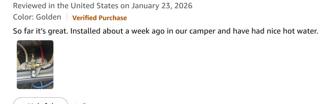

    I was noodling around looking at mixing valves yesterday (I'm sure everyone does this sort of thing, amirite?) I know that a couple of owners have simply yanked these convoluted "thermostatic" valves from the trailer and replaced them with just ordinary "adjust with a screwdriver" mixing valves.
    When I searched Amazon for the Cash Acme valve Muttonchops listed above, I ran across this "Tremax" valve. One of few reviews had a picture of this valve plumbed into a 400. It would seem there are many different mixing valves that can easily be adapted to the Tabs. There doesn't seem to be much reason to stay with the valves provided by NuCamp if you have some simple skills to put in something that might perform better.
    TreMax Mixing Valve Amazon

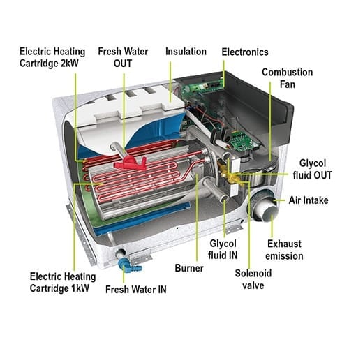

    AND, one more thought…………….it may be time to give Alde/Truma a call to see what suggestions they have to offer.
