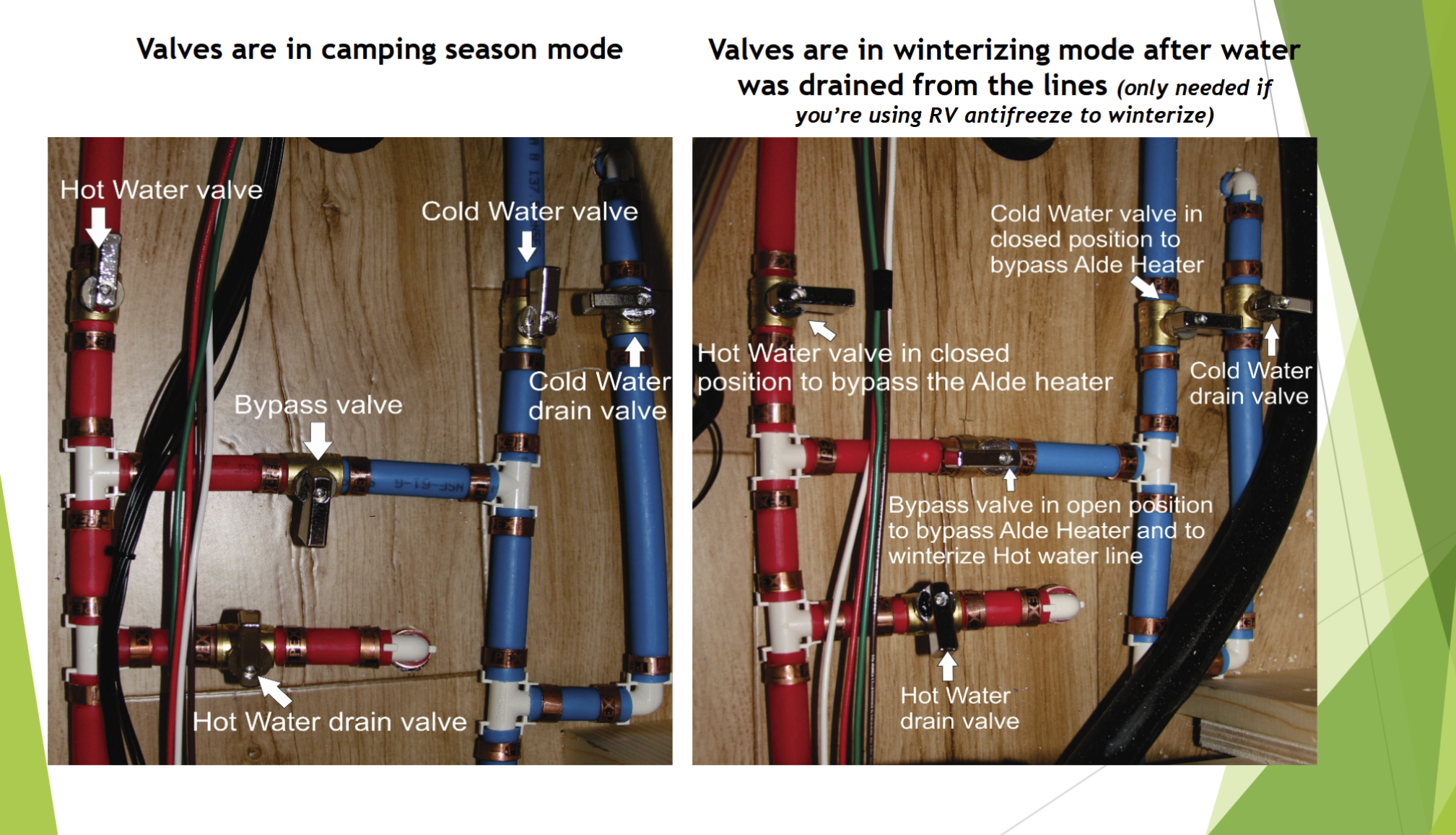

    i am winterizing my tAB 320 S _2019 model and forgot to drain the water heater and have already added the antifreeze. What should i do?
    pthomas745 Administrator, Moderator Posts: 4,684
    If your valves are in the "Winterized" position, nothing should have gone to the Alde tank. See the photo below, the part on the right side. With the valves in this position, nothing should have gone to the Alde. Look closely at the two valves on the red and blue pipes: the "Hot Water Valve" and the "Cold Water Valve". If they are closed, no antifreeze should have made it to the Alde tank.
    The Alde hot water tank drains in two ways: by opening the cold water low point drain, and by opening the Yellow Flapper Valve. The thing to do now would be to open the Yellow Valve and see if there is water in the tank. There probably will be some left over, but the cold water low point probably took care of quite a lot of it.
