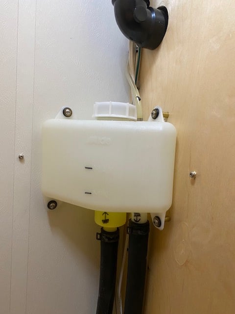

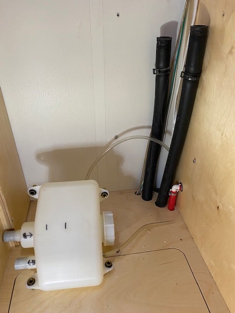

- Accessing the equipment. Most glycol exchange methods will involve needing to access the glycol expansion reservoir and its associated plumbing. Ease of such access will vary on different units, but is likely to be challenging on T@B 320s where the reservoir is either behind the rear cabinetry or (in the case of CS models) behind the bathroom wall.

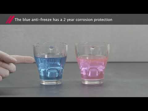

Here is an Alde YouTube video on testing of the European G13 antifreeze. Obviously the Century TF-1Transfer Fluid often found in USA T@Bs is different than shown in video, and non-toxic (GRAS) generally recognized as safe. "Century recommends professional system preparation and fluid introduction."Century recommends testing PH every 6 months. PH should be between 7 and 8. Haze point (first ice crystals observed) (-34F)
https://www.youtube.com/watch?v=znf7EOJnvLY Kay and Tom - SW Wisconsin - Silver T@bernacle - 2018 T@B 320S Boondock Silver/Black trim TV, 2018 Chevy Colorado, Silver/Black trim, Duramax, TowHaul, IntelliHaul0 -

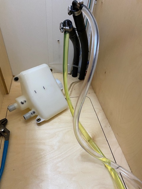

Yep, that is the general idea I'm toying with--pump it in one end until you collect the desired volume from the other. This assumes I can get reasonable access to the hoses at the reservoir, and that the system is able to self bleed after a complete exchange.RCB said:...Having said that, there are a number of inexpensive liquid extraction pumps on amazon that might help in the draining process....
