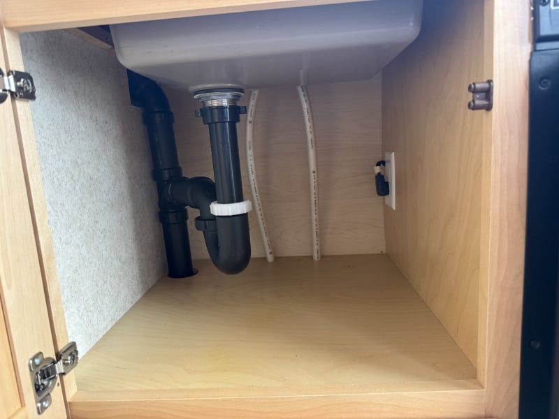

    I did this one.   My first post   2019 320 SBD. The sink didn’t let me route directly to the drain.
    Is the black drain pipe securely mounted to the grey tank?  Mine isn’t and can be lifted up and down inside lower cabinet.
  • ScottGScottG Administrator Posts: 5,654
    Good question. My guess--and that's all it is--is that the black drain enters the grey tank through a rubber flange of some sort. This would allow a bit of movement as the trailer gets banged six ways from Sunday rolling down road.

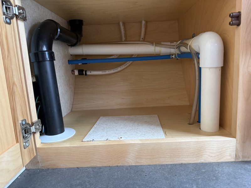

    @GPS_Jon
    Another non-plumber person who used the rubber couplers rather than PVC glue.
    I kept the p-trap. Swung it to the back out of the way.

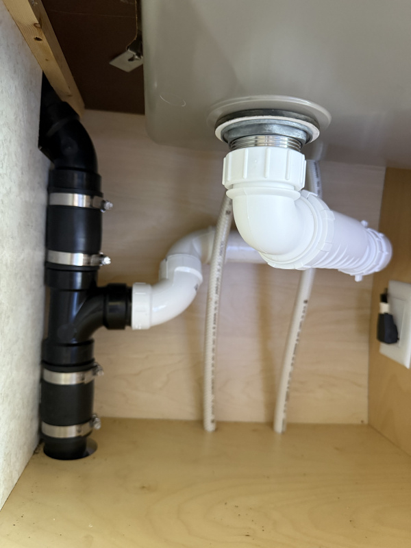

  • GPS_JonGPS_Jon Member Posts: 2
    edited April 5
    AnOldUR said:
    @GPS_Jon
    I like your setup.  More room without spending money on the waterless trap. I used the Fernco couplers so I could rotate the sweep and not use a T. I might have gone with your approach if I saw it first. Either way, for the extra room in that cabinet it’s worth the modification.
    I filled up the sink and pulled the stopper.  The sink drained quickly and most of the water went into the grey tank.  There was maybe two cups on the ground.  My black pvc pipe must not be seated in the tank.  I’ll have to pull the shroud and see if I can get eyes on it.  The plumbing I added had no leaks.
    edited April 6
    In light of this, I retract my earlier guess about the rubber flange. Given the amount of leakage I'd say your drain pipe has parted ways with your grey tank. Please report back what you find and, if applicable, how you fix it.
