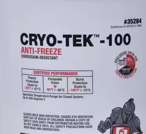

  • hye4tab
    hye4tab Member Posts: 6
    Hello everyone, I tried really hard to process what you guys talked about so far but I think I barely got about 10% out of the whole discussion.🤣
    Now, I have another question about the coolant itself. I have a friend who has a Sprinter which came with 3010 Alde heater. He replaced his green coolant with the purple one from Cry-Tek-100 last year. And it works fine, he said. He did that because he doesn't have to replace it as often as every 2 years, I think he said it only needs to be replaced every 5 years.
    https://www.homedepot.com/p/Oatey-Cryo-Tek-5-gal-Non-Toxic-Corrosion-Resistant-Antifreeze-35284/305674151
    I have a 2022 320CSS, can I use the purple one on my Alde 3020 model? Any comments would be really appreciated.
    Thank you and have a wonderful summer!
    2022 320 CS BD
  • Grumpy_G
    Grumpy_G Member Posts: 784
    A Quick Look at the link shows "Not for use with galvanized, CPVC or aluminum". So there's that…
